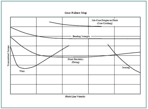

Running gears can fail via a number of modes, many of which are shown generically in Figure 1. Screening tests are conducted in a manner that allows evaluation of performance relative to one of these modes while avoiding damage via the others. A common approach is to evaluate bending strength using the single-tooth bending fatigue test (STF) and surface durability using the rolling/sliding contact fatigue test (RCF). From the bending strength point of view, this ensures that tests intended to evaluate bending strength will not have to be terminated due to surface durability (pitting, wear or scoring) failures. The design of running gear test specimens to evaluate bending strength (or surface durability) requires a good initial estimate of bending strength so that the specimens can be designed to fail by the target failure mode at about the desired life without undue risk of failure by unwanted modes. This paper describes a method developed by the Gear Research Institute to extrapolate running gear bending
Figure 1—Gear failure map.
strength data from STF results that is invaluable in comparing bending performance of different materials and processes. This methodology has also proven useful in the design of running gear bending strength test specimens. It is strongly recommended that data extrapolated by this or other similar methodologies should not be used as the basis for the design of gears for applications.

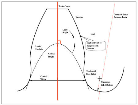

Before comparisons can be made between tests with specimens having differing geometries—such as those used in STF and running gear tests—the applied test loads must be converted to bending stress. Figure 3 shows a spur gear tooth with a point load applied at the highest point of single-tooth contact. This point of loading corresponds to the highest bending stress when there is effective load sharing between gear teeth. Specimen gears used in rig tests should have effective load sharing, so this is the appropriate point of loading for determining bending stress for running gear specimens used in rig tests. For gears tested in single-tooth bending fatigue, the actual point of loading established by the test fixture is used in calculating bending stresses.
Figure 3—Layout of spur gear showing loading and Lewis parabola.
The Lewis parabola is drawn from the point the load line intersects the center of the gear tooth and is tangent to the root fillet. The methods used to lay out this parabola vary, depending on how the root form is generated, and the full particulars are lengthy and presented in detail elsewhere (Ref. 3). The critical height and width are determined from the Lewis parabola as shown in Figure 3. The angle between the load line and a normal to the tooth center is termed the load angle (it differs from the pressure angle at the point of loading because of the thickness of the tooth). The bending stress is thus:
Where
s = Critical Width from Lewis Parabola
h = Critical Height from Lewis Parabola
r = Minimum Fillet Radius
H = 0.331–0.436 x (Nominal Pressure Angle – Radians)
L = 0.334–0.492 x (Nominal Pressure Angle – Radians)
M = 0.261–0.545 x (Nominal Pressure Angle – Radians)
This equation for bending stress can be derived from first principles or from AGMA standards (Refs. 3, 4) by taking the forms of relevant formulas pertinent to spur gears and setting all design factors at unity. A similar formula could be developed for helical gears.
For a given gear design and loading condition, such as the Gear Research Institute’s Standard STF specimen, loaded in its standard fixture, Equation 1 can be simplified to the following form:
Bending Stress = Load x Stress Factor
Where the stress factor comprises all the items on the right side of Equation 1 except load. For the Gear Research Institute’s standard STF test, this becomes:
Face Width 1.000 inch
Load Angle 24.8 degree
h 0.286 inch
s 0.335 inch
Kf 1.53
Stress Factor 19.3 psi bending stress per pound load

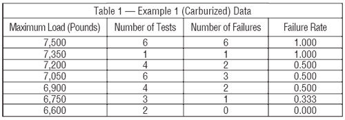

Example 1—Case Carburized Gears. The STF specimen gears used in the program the first set of sample data was taken from are Gear Research’s standard pattern; hence the factor for converting load to stress is 19.3 psi bending stress per pound of load. The test results are summarized in Table 1.
Figure 5 shows the first statistical diagram constructed from this data. This diagram is used to select the load that corresponds to 50% failures; in this case the value is 7,050 pounds, which appears intuitively obvious from an examination of Table 1. The reciprocal of the slope of the fit lines shown in Figure 6 is taken as 10% of this value. Figure 6 shows the statistical step from STF to running gear data. In this case, the selected slope of the fit lines appears to fit the data very well. The translated R = 0.1 running gear G50 maximum load is 5,700 pounds, which corresponds to 110 ksi maximum bending stress. The allowable stress range diagram shown in Figure 7 shows the adjustment of this stress to R = negative 0.2 stress, which is 94.9 ksi.
