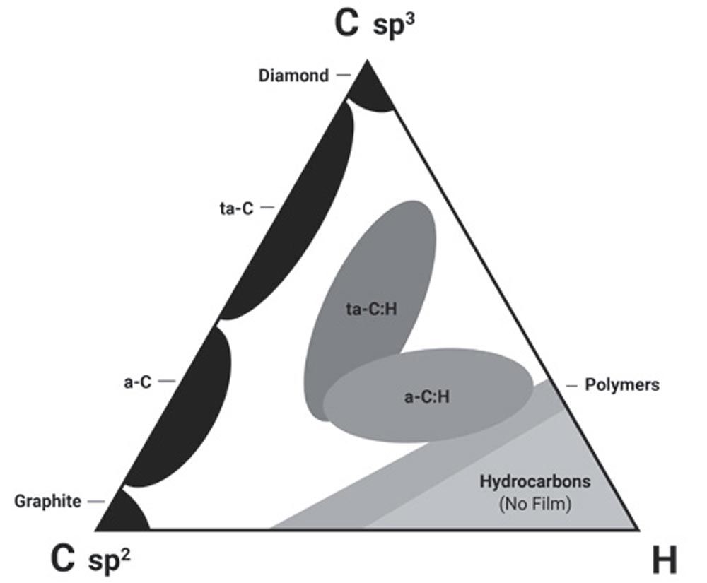

As seen in Figure 1, the ratio of spto sp3 carbon bonding has a direct effect on the properties exhibited by a DLC coating. Besides, sp2/sp3 ratio, hydrogen content impacts the properties exhibited.
Figure 2—Ternary phase diagram for DLC thin films. Adapted from Ref. 1.
