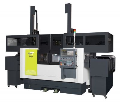

Tongtai’s newest MT Series Lathes were developed for improving cycle times and turning processes for the automotive industry, where small parts are typically made within 60 seconds. Tongtai developed the MT series for precision turning, high production volume, automatic production, and insertion into mass-production lines. Tongtai machines are available from Absolute Machine Tools, Inc., headquartered in Lorain, OH.
The MT Series has twin spindles and two individual machining areas. The turrets and spindles are designed parallel to each other. This design makes parts that usually need two processes to be finished on one machine. The addition of a gantry-type robot saves floor space and improves labor flexibility. Depending on cycle time, a single robot arm/single stocker or twin robot arms/twin stockers for high production chucking work are both available on these lathes. The Tongtai MT lathes come equipped with either 6" or 8" chucks on spindles that rotate at 6,000 or 4,500 RPMs respectively. The control system offers a robot teaching function so that the operator can adjust positioning. The function coordinates the robot arm, on-screen positioning diagram, input coordinates, number and names of positions, three axes settings and single axis settings.
The work area on the main foundation of the lathes has two individual working areas with separate bed structures. This design decreases the transferring of harmonic vibration, contributing to excellent machining accuracy and high quality surface finishes. The compact design allows for a short cutting flow from start to finish, which enhances machining rigidity and heavy cutting ability. Maximum swing diameter is 210 mm with a machining diameter of 210 mm or 120 mm (with robotic arm), and machining length of 145 mm or 100 mm (with robotic arm).
The MT series lathes are equipped with workpiece positioning protection to ensure sealing between the workpiece surface and chuck. Pneumatic pressure leaks can be detected, and if this occurs, the robot arm will reload the workpiece. The gantry type robotic arm is able to process three axes of movement and is driven by a servo motor. The programmable arm allows the operator to adjust positioning points and moving routes. Rapid traverse for the robotic arm are 160 m/minute in X, 120 m/minute in Y, and 35 m/minute in Z. The rotary axis moves at 180° in one second.
The pallet stocker comes in three types: three poles and a center, three poles, and a central pole type. The number of pallets ranges from 10, 14, and 16 with allowable part diameters all at 30 mmΦ through 150 mmΦ.
The MT series comes standard with coolant through the spindle, A2-5 or A2-6 spindle nose, 0.001" indexing increments, 4,500 RPMs or 6,000 RPMs optional. With cutting feed rates of 0.001-5,000 mm/minute this horizontal turning center is perfect for high production fast-paced manufacturing environments.
