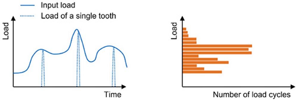

In general, linear DAH traces back to the theory according to Palmgren (Ref. 3) and Miner (Ref. 4) and is based on the following assumptions:
  • Every load cycle of a certain load level causes the same amount of damage.
  • The amount of damage caused by any load cycle does not depend on the previous damage already caused to the component.
These assumptions basically lead to an entire neglect of the load sequence. Therefore, it is possible to use a load spectrum instead of the actual load sequence, which in many cases is the only feasible way because the load sequence is not known during the design process. On the other hand, in many cases, the load spectrum can be estimated with a certain amount of reliability. To generate a load spectrum, the occurring range of load is divided up into a certain amount of load levels, and the occurring load cycles are categorized accordingly (Ref. 5). For gears, every tooth of a gear is exposed to one load cycle for every revolution of the gear. Due to this characteristic, it is possible to transfer a load sequence into a load spectrum without the use of complex methods such as the Rainflow-counting algorithm. Figure 2 shows a schematic load sequence and the corresponding load spectrum. Additionally, the load sequence of one single tooth is plotted.
Figure 2—Schematic load sequence (left-hand side) and load spectrum (right-hand side).

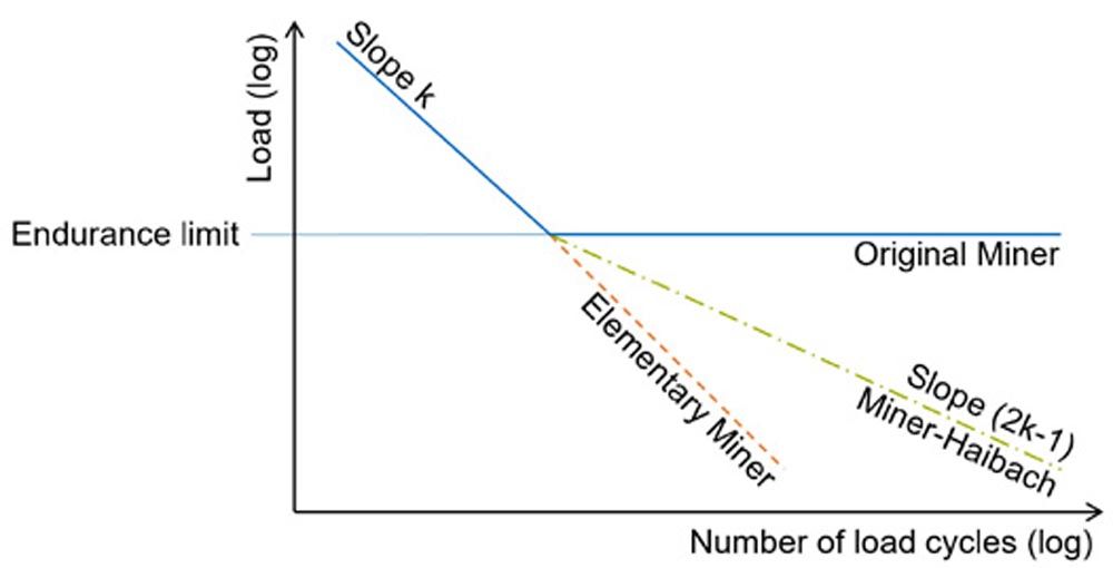

In its original form, the DAH according to Palmgren (Ref. 3) and Miner (Ref. 4) (also referred to as “Original Miner”) does not consider any load levels lower than the endurance limit. Therefore, it is assumed that all load cycles of the corresponding load levels do not cause any damage. Especially high loads can result in a decreasing endurance limit throughout the service life (Ref. 9). This effect can result in an underestimated damage sum, not representing the actual state of damage and overestimating the service life. To include this into the DAH, two variations of “Original Miner” were developed:
  • Elementary Miner: This DAH ignores the endurance limit and calculates the number of allowable load cycles according to Equation 1 for every load level.
  • Miner-Haibach: The DAH “Elementary Miner” attributes load levels below the endurance limit with a high contribution to the total damage. This often leads to a very conservative damage estimation. Therefore, Haibach (Ref. 12) developed a DAH based on the Miner hypotheses, but with a reduced slope of 2k-1 for loads below the endurance limit.
Figure 3 shows the number of tolerable load cycles as assumed by the three presented DAHs based on the theory according to Palmgren (Ref. 3) and Miner (Ref. 4).
Figure 3—Number of tolerable load cycles as assumed by the DAHs based on Palmgren and Miner (Ref. 11).

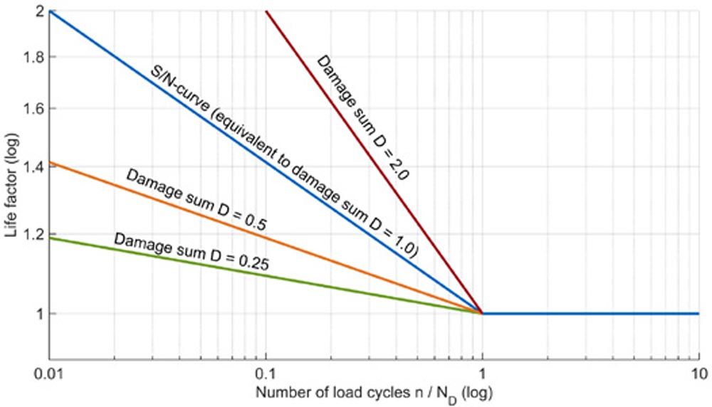

Figure 5 shows the same damage sums and their locations as function within the S/N diagram for the DAH according to Subramanyan (Ref. 10).
Figure 5—Different damage levels according to Subramanyan in the S/N diagram.
The damage levels for the DAH according to Subramanyan (Ref. 10) are not parallel within the S/N diagram. This is due to the nonlinear approach and therefore the sequence of loads has an impact on the resulting damage sum.

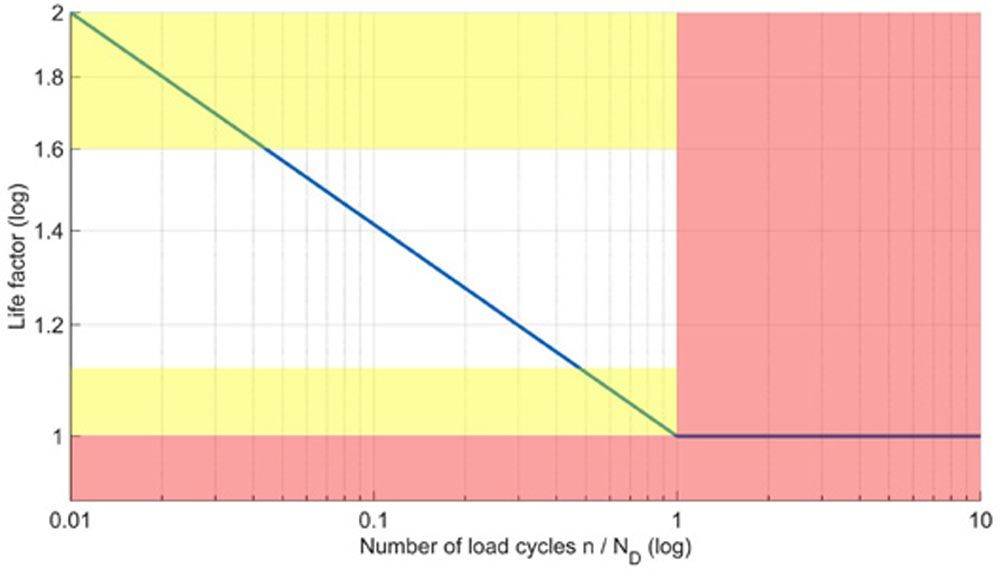

The DAH according to Subramanyan (Ref. 10) has some major limitations:
  • Loads lower than the endurance limit cannot be integrated into the calculation. Therefore, these loads must be excluded similar to the DAH “Original Miner.” Since all damage levels have their origin in the knee point of the S/N curve, it is not possible to integrate loads lower than the endurance limit similar to the DAHs “Elementary Miner” and “Miner-Haibach.”
  • As presented in Figure 5, all damage levels originate at the knee point of the S/N curve and become steeper as damage increases. Due to this fact, it is not possible to have a number of load cycles n larger than the number of load cycles at the knee point of the S/N curve ND. This would cause the damage sum to become negative and is therefore illogical. This issue can be retraced when looking at Equation 4. Especially when the scattering of the service life of input data is quite high, this can cause an issue.
  • According to the original publication (Ref. 10), the method is not suitable for loads slightly above the endurance limit and for very high loads. This is due to the course of the damage lines. Unfortunately, there is no reliable statement about the range of loads, which should be avoided when calculating with this DAH.
Due to the mentioned limitations of the DAH according to Subramanyan (Ref. 10) the range of load and number of load cycles the DAH can be applied for is limited. Figure 6 shows the usable areas within the S/N diagram in white. The red areas within the figure are not mathematically valid and the yellow area represents the issue with loads slightly above the endurance limit and with high loads. Because there are no concrete limits for the load given in the literature, the limits were set at a life factor of 1.1 and 1.6 by the authors for this paper. The upper limit was chosen in a way that the corresponding load is sufficiently below the typical range of the static strength of the gear. This is to ensure that the load still results in a service life and does not lead to immediate failure. The lower limit is chosen at 1.1 to ensure a minimal distance to the endurance limit while maintaining a wide load range to apply the DAH according to Subramanyan (Ref. 10).
Figure 6—S/N diagram with limitations of the DAH according to Subramanyan (Ref. 10).

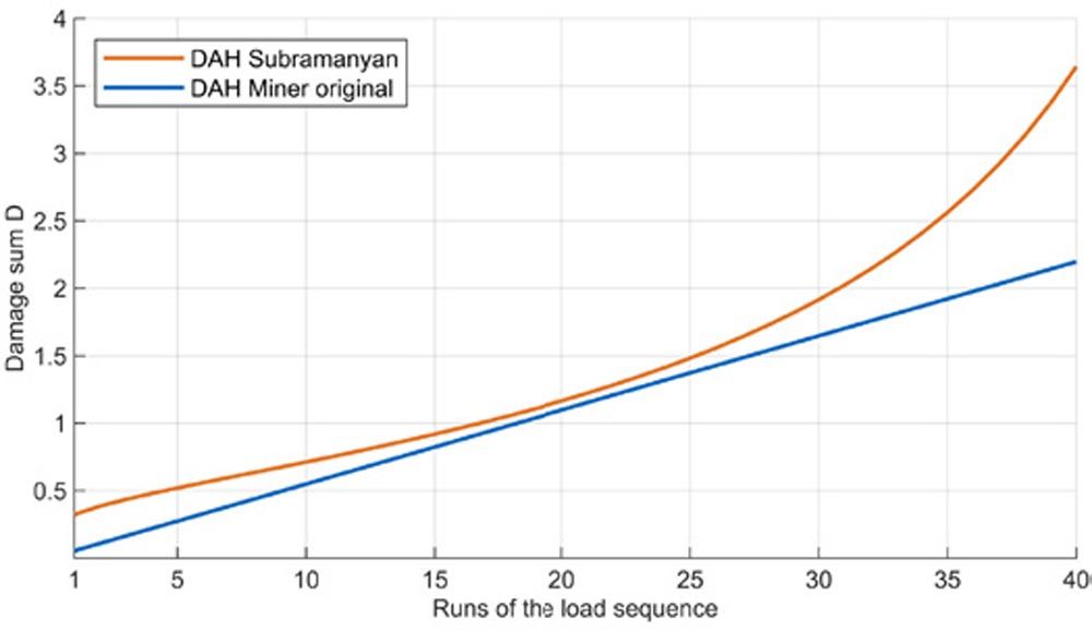

Impact of the Nonlinear Calculation

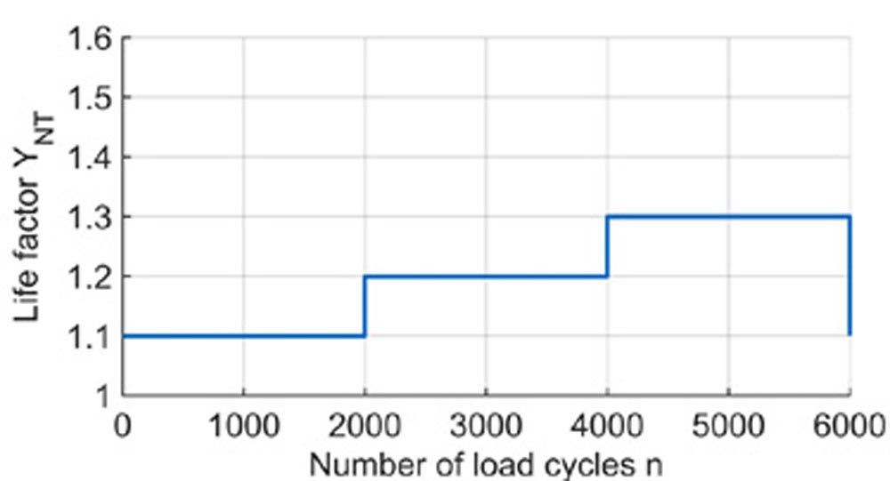

The nonlinear approach changes the results of the damage accumulation and therefore a different damage sum can be expected when comparing it to the linear approach according to Palmgren (Ref. 3) and Miner (Ref. 4). Table 1 shows a comparison of the resulting damage sum according to the DAH “Original Miner” and the DAH “Subramanyan” for three different load sequences. All these load sequences are designed to result in the same damage sum according to the linear approach. The difference between the three sequences is the intensity of the load mixing. This comparison is not designed to determine which of the theories is better suited for gears. Rather, the objective is to show the differences resulting from the various formulae.
The results presented in Table 1 (located at the top of page 44) show two trends:
  • The DAH according to Subramanyan (Ref. 10) results in much higher damage sums compared to the DAH according to Miner (Ref. 4). The increase is between 106 percent and 118 percent.
  • According to the DAH “Subramanyan” a load sequence is increasingly damaging with increasing load mixing. The difference in this case is up to 5.5 percent.
The influence of the different intensities of load mixing is within a realistic range. The general differences in the resulting damage sums are very high and unexpected. To understand the impact of the calculation, Figure 7 compares the development of the damage sum with an increasing number of runs of the load sequence with high load mixing, as presented in Table 1.
Figure 7—Comparison of the damage development.
Load sequenceDamage sum according to DAH “Original Miner”Damage sum according to DAH “Subramanyan”
   High load mixing
0.21970.4791
   Moderate load mixing
0.21970.4699
   Low load mixing
0.21970.4530
Table 1—Comparison of the damage sum according to different DAHs – Influence of load mixing.
The results presented in Figure 7 show that the difference in the damage sum between the two DAHs first decreases with increasing runs of the load sequence and then increases again for damage sums greater than about 1.3. In the range around a damage sum of 1, the two DAHs are quite close. Therefore, it can be assumed that both DAHs can be expected to predict failure with a reasonable difference. Based on this theoretical comparison, it is not possible to determine which of the two is more suitable for gear fatigue. Therefore, a comparison with the experimental data is necessary.

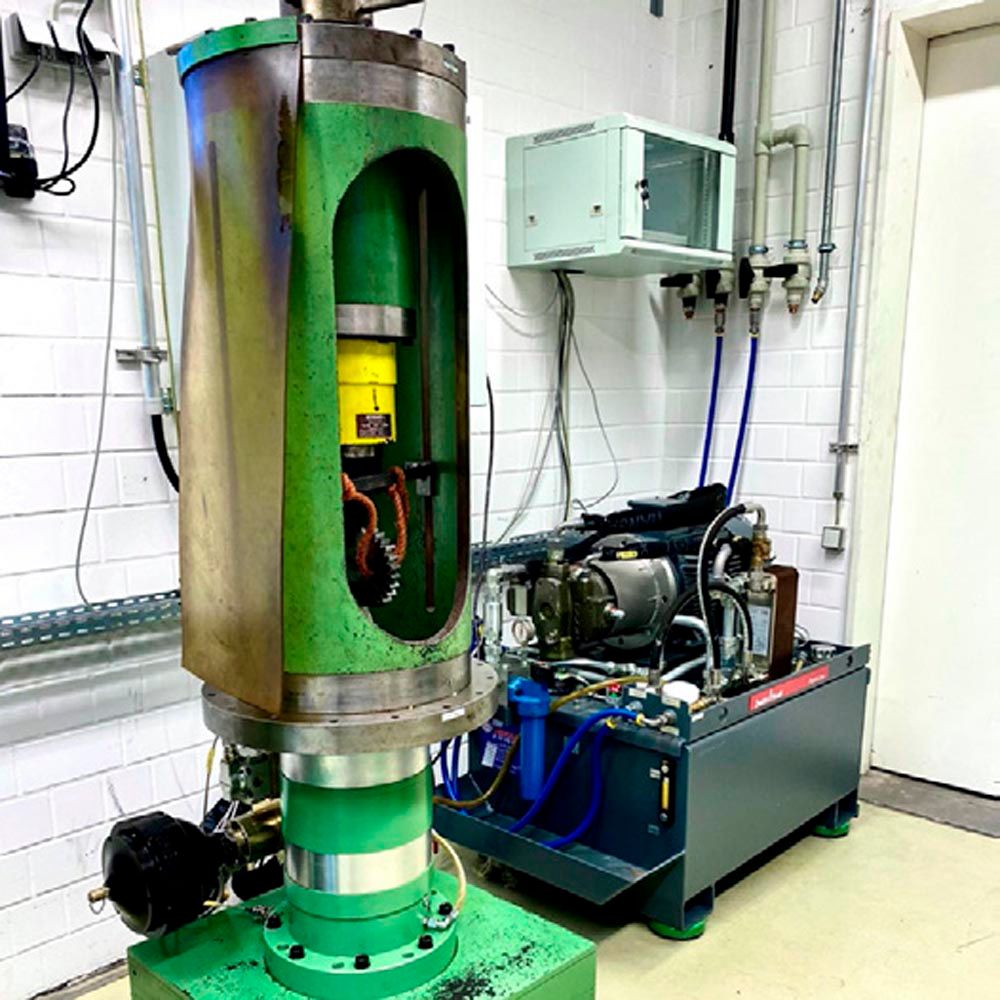

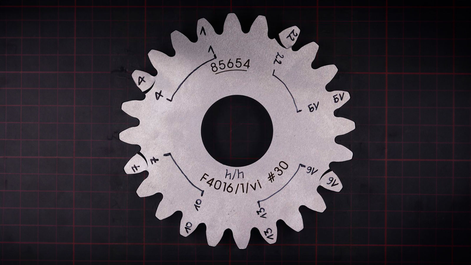

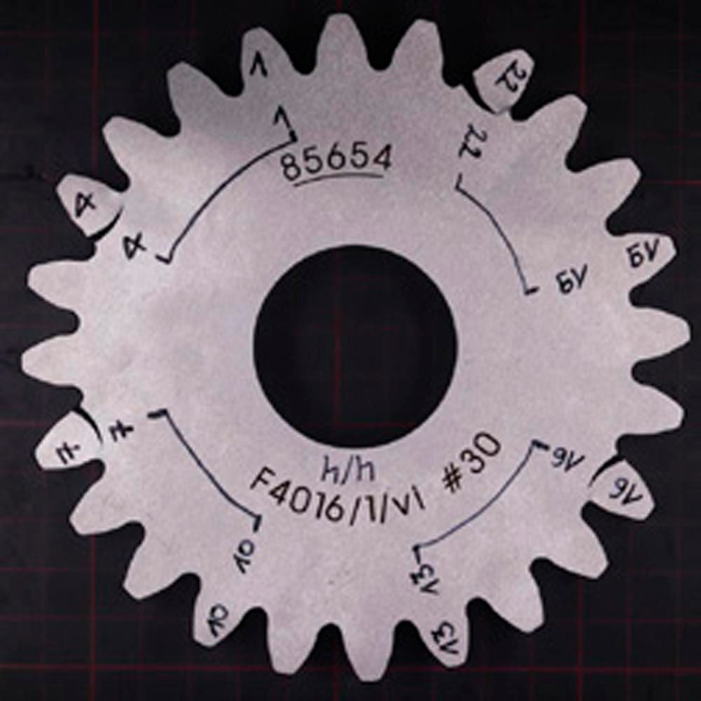

To compare the suitability of different DAHs for the prediction of the service life of gears under variable load, a dataset of fatigue tests with variable load sequences is required. For the tests, a pulsator test rig was used at the FZG. This test rig enables a time-efficient test procedure that allows an extensive data set to be realized. Figure 8 shows the test rig used. For the tests, a special gear design was applied, which is optimized for this kind of test and has already been used in several research projects at the FZG. Information about the gear is presented in Table 2.
Figure 8—Test rig.
GearSpur Gear
Normal Modual5 mm
Number of teeth24
Face width20 mm
MachiningMilling and grinding
MaterialSteel 18CrNiMo7-6
Heat treatmentCase-hardened
Table 2—Gear data and picture of tested gear with four datapoints.

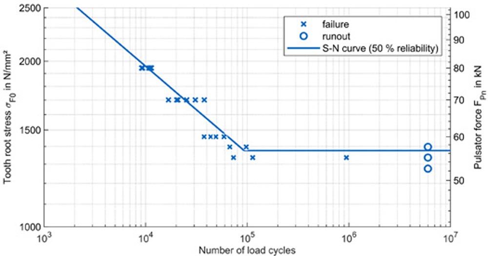

Figure 9—S/N curve of the tested gear.
To enable a calculation according to the DAHs “Original Miner” and “Subramanyan” a S/N curve is required. The S/N curve was determined following the procedure described by Tobie (Ref. 13) and is shown in Figure 9. The limit of load cycles, at which a test was declared a runout, was set at six million.

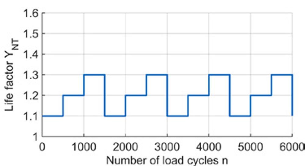

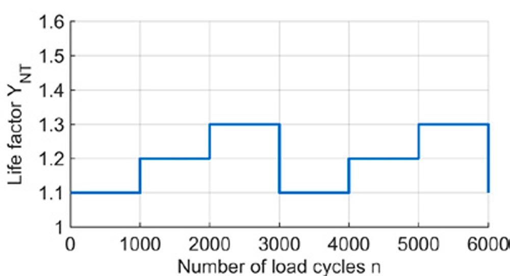

To compare different DAHs for their suitability for the fatigue of gears, a dataset with service life information under variable load is required. For this test series, the same test rig and the same gears as presented in the section “Setup and S/N Curve” were used. Two different types of variable loads were investigated with three assorted characteristics. The six different load sequences are presented in Table 3.
Influence of overload timingInfluence of load mixing
Early life overloadHigh load mixing
Midlife overloadModerate load mixing
Late life overloadLow load mixing
Table 3—Applied load sequences.

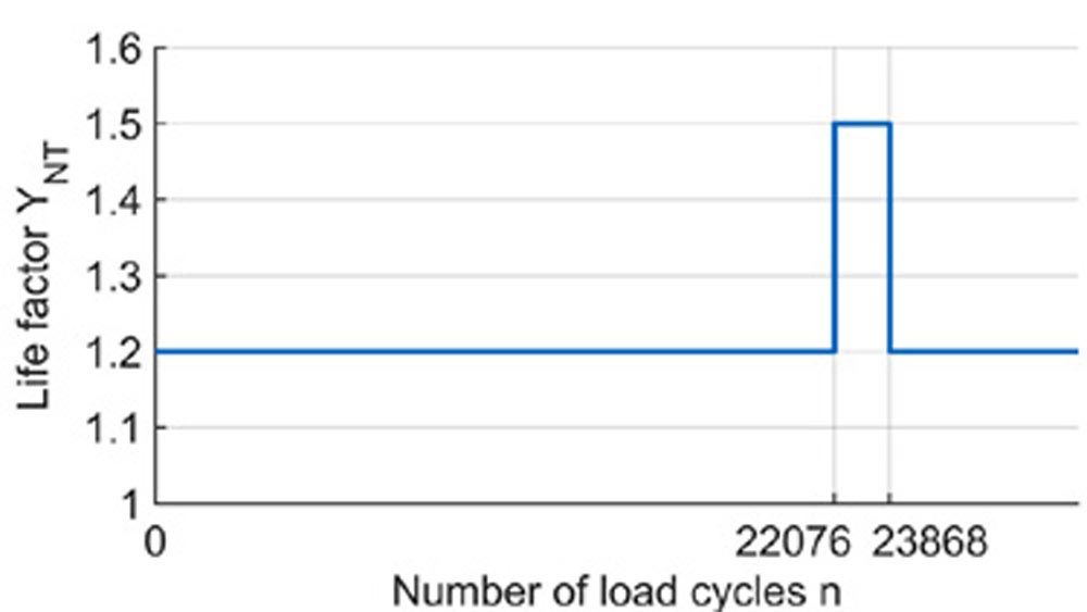

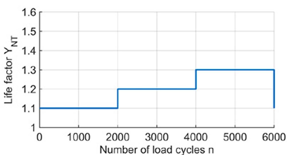

The load sequences regarding the influence of the load mixing are like the ones used in the section “Theoretical Comparison of Palmgren/Miner and Subramanyan” for the theoretical comparison. For the tests, the sequence is repeated until the gear fails due to a breakage of one tooth. The test was conducted ten times for each of the three load sequences.

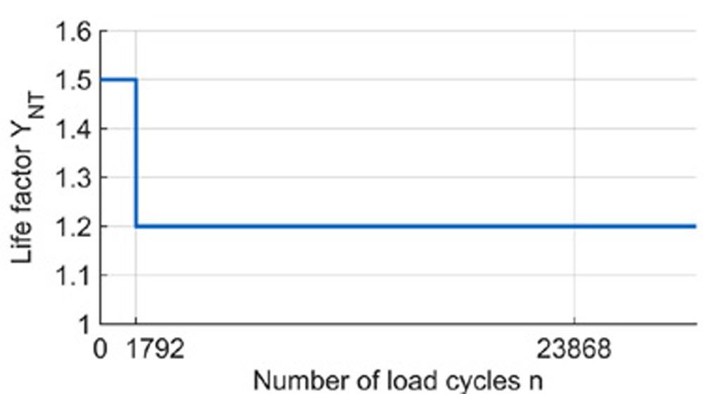

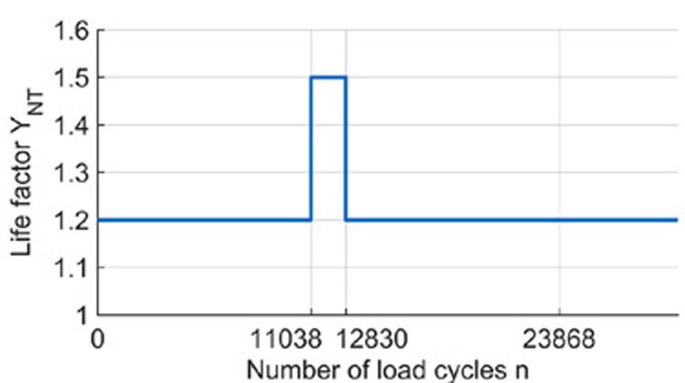

To test the influence of the timing of a high load or overload, three different load sequences were designed. Reference for the sequences is the damage sum according to the DAH “Original Miner.” The length of the high load is chosen in a way to account for a damage sum of 0.25. The position within the sequence is chosen as follows:
  • Early-life overload: The load sequence starts with the overload.
  • Midlife overload: The overload is positioned in a way that it is in the middle of the theoretical service life according to the Miner hypotheses (Ref. 4), which would end at a damage sum of one.
  • Late-life overload: The overload is positioned in a way that it is at the end of the theoretical service life according to the Miner hypotheses (Ref. 4), which would end at a damage sum of one.
If a gear has not failed at the end of the sequence, the test ends with a constant load until the gear fails. The sequence is not repeated and therefore the overload only occurs once. As for the influence of the load mixing, the test was conducted ten times for each of the three load sequences.

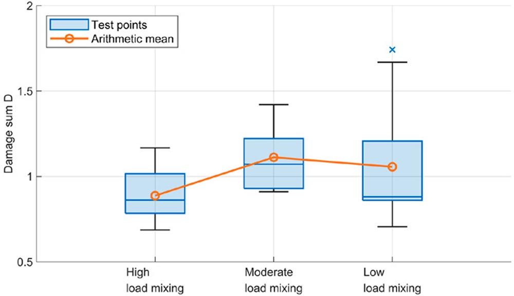

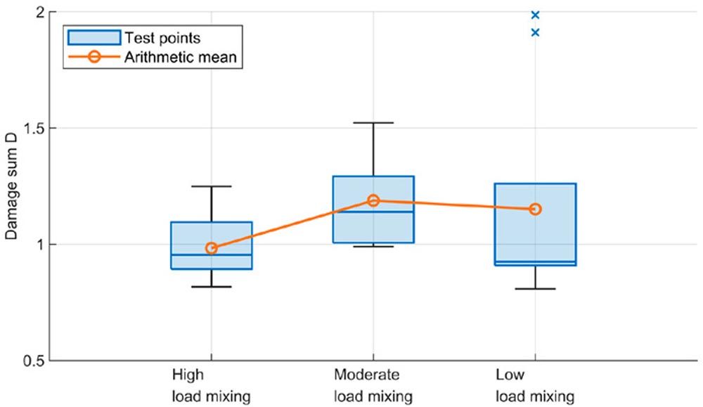

The results of the test series investigating the influence of the load mixing are presented in Table 4. The data is analyzed with the DAHs “Original Miner” and “Subramanyan” and is displayed as boxplots.
Results according to DAH “Original Miner”
Results according to DAH “Subramanyan”
Table 4—Results of the test series regarding the load mixing.
The results indicate that load mixing influences the service life of gears. When looking at the damage sum according to “Original Miner” the service life of gears is significantly decreased in the case of high load mixing. Moderate and low load mixing results in similar mean values, but the scattering of test points is significantly higher with low load mixing. These observations correspond to the results according to Stahl (Ref. 9). A high number of load changes results in a significant reduction of the service life.
When comparing both DAHs, the results show similar trends. In general, the DAH according to Subramanyan (Ref. 10) results in higher damage sums than the DAH “Original Miner”. The scattering of the damage sums within the data points of one load sequence differs for both DAHs. This can be explained by the nonlinear growth of the damage sum when applying the DAH “Subramanyan” (compare Figure 7). These observations are consistent with the theoretical comparison in the section “Theoretical Comparison of Palmgren/Miner and Subramanyan.” The deviations between the calculated service life of the three load sequences are very similar, especially for a qualitative comparison. For this reason, the DAH “Subramanyan” does not provide any added value over the DAH “Original Miner” in this case.
