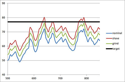

Taken a step further, various manufacturing processes may also be evaluated within the context of mass-production. Figure 3 shows such a gear whine prediction exercise, factoring in gear microgeometry variation due to both a shaving and grinding process, and comparing the results to a tonal noise target directly related to passenger compartment subjective ratings.
Figure 3 Radiated Gear Noise vs. Tonal Target
- Click image to Enlarge
A quick review of the plot shows why gear whine issues may emerge during the critical launch phase. Note the nominal designs all reside below the defined tonal noise target. This is a normal expectation, since prototype gears are often watchfully ground or shaved with non-production tooling, with the intention of producing gears as close to the print design as possible.
But, if the effects of the manufacturing variation are factored in for the shaving process, it’s clear that even with all dimensions well under control, a certain percentage of the production population will exceed the allowable tonal noise limits. Alternatively, the predicted noise performance of the population using the grinding tolerances will be under the target.
The purpose isn’t to show that grinding is required; the purpose is to show a methodology factoring in relevant population performance when making critical design and manufacturing process decisions, as early as possible. If the program direction from the example is to use shaving, a re-design to improve transmission error is easier to implement before the design freeze and toolordering dates. This variation information is practically impossible to acquire using test or, within a certain range of uncertainly, using “experience” only. The advanced CAE tools improve the OEM’s ability to make smarter choices for prototype builds and subsequent testing by pinpointing critical features and identifying worst-case production assemblies, in addition to predicting nominal performance, so the testing can better represent the full range of production possibilities.
