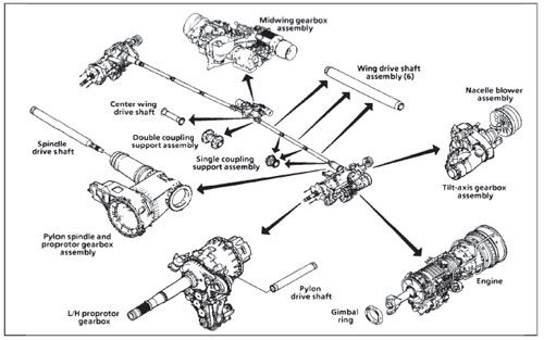

High-speed, heavily loaded and lightweight gearing components are found in propulsion systems for rotorcraft. The high pitch-line velocity that is part of these systems makes the thermal aspects of the gear system design very important. Also, transmission systems used in certain applications have gear trains that provide the proper spacing between the parallel engine and rotor shafts (Ref. 1). These gear trains can cause additional thermal problems as the idler gears in this system receive two meshing cycles (on opposite sides of the gear teeth) per revolution. Therefore, weight-optimized aerospace drive system components can have difficulty when operation includes primary lubrication system failure.

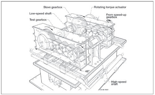

Test Facility. The test facility used for this study is shown in Figure 1. The facility is a closed-loop, torque-regenerative testing system. There is a test gearbox and slave gearbox that are basically mirror images. Each gearbox has an input gear, three idlers and one bull gear. The gearboxes are joined together through the input gears and bull gears via shafting.
This article appeared in the March/April 2008 issue.
Figure 1—NASA High-Speed Helical Gear Train Test Facility.

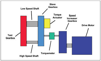

The facility is powered by a 500 hp DC drive motor, and its output speed is increased using a speed-increasing gearbox. The output of the speed-increasing gearbox then passes through a torque and speed sensor before connecting to the slave gearbox. The entire test stand configuration is shown in Figure 2.
Figure 2—Layout of NASA High-Speed Helical Gear Train Test Facility.

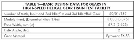

Test Hardware. The test hardware used in the tests to be described is aerospace-quality hardware. The basic gear design information is contained in Table 1. The input and bull gear shafts have a combination of roller bearings with ball bearings to contain the resultant thrust loads, whereas the idler gears only have roller bearings. The partially disassembled test gearbox is shown in Figure 6. The bearing inner race is integral to the shafts on the idler gears and at other radially loaded bearings on the input and bull gear shafts. Shrouds for the gears were used to minimize the windage losses. Figure 7 shows the shrouds installed in the test gearbox.

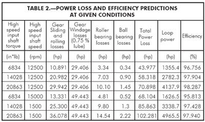

The first set of results is presented as an example of the large amount of data taken throughout this study. The test shown in Figure 10 was attained for the superfinished gears, keeping the lubricant inlet temperature and pressure constant. In Figure 10, the array (thermocouple #5) and rake (thermocouple #3) mid-temperature locations are shown for seven conditions of this particular test. The seven conditions included a warm-up; then three conditions of torque at 12,500 rpm; and finally the speed was increased to 15,000 rpm and the three torque conditions repeated. The test operational conditions can be found in Table 2 with a summary of some of the other data of interest. In this figure, typical for this gear system, the array temperatures were always much higher than the corresponding rake temperatures at the same location. As shown in this figure, the maximum temperature over the inlet lubricant temperature was on the order of 180°F.
Figure 10—Superfinished temperature data at mid-face rake and at array center for all sensor locations (conditions shown in Table 2, one scan = 2 s, 160°F oil inlet temperature).
