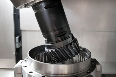

The machining strategy, which is realized on a Pittler SkiveLine, follows a different approach. By machining the toothing and the cam bore in one clamping, the clamping device for machining a cycloid disc can be designed more simply without negatively influencing the form and position quality. The advantage of complete machining in one clamping is that the reference of the cam bore and gear teeth can be generated and corrected via the machine. This machining strategy even leads to a further improvement of the position quality. In this way, the Pittler SkiveLine contributes to solving an apparent conflict of objectives - to reduce manufacturing costs with improved quality.
In addition to external gearings, internally toothed housings can also be completely machined on a Pittler SkiveLine. This is possible by creating the special profiles with Pittler Skiving and machining all other functional surfaces by turning, drilling, and milling. The machining of components for robot gears on a Pittler SkiveLine is not limited to the green machining itself. To achieve the highest quality, the already toothed and hardened components can be finely machined. Here Pittler can fall back on the modular technology of the DVS Group.
