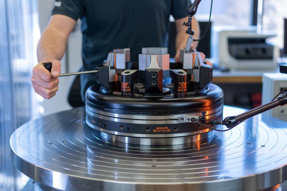

The completed clamping solution was about more than just clamping and unclamping. It was about the coordination of many movement sequences, a complex control system and finally the huge size of the clamping device which has a base plate of 23 x 14 inches (580 x 360 mm) and weighs in at over 353 lbs. (160 kg).
It is interesting to note that the required holding torque could not be easily checked. A 6.5-ft. (two-meter) long torque wrench had to be used. Once the holding torque was verified, the customer setup the six clamping devices on the machine. The configuration had three devices inside the machine and three devices outside the machine -- all on palletized tables. This setup allowed the three clamping devices in the machine to be operated simultaneously, which significantly increased the volume of machined workpieces. The other three clamping devices, which are located outside the machine, can be unloaded/ loaded concurrently, which also increases production volume.
The planetary gear carrier clamping device has a solid foundation that is a specially designed plate (2) on which the other components are installed. All hydraulic and pneumatic lines, including the external connections, are connected to this plate. There are distinctive hydraulic connections and mounts for the load bars which are necessary due to the total weight of over 353 lbs. (160 kg).

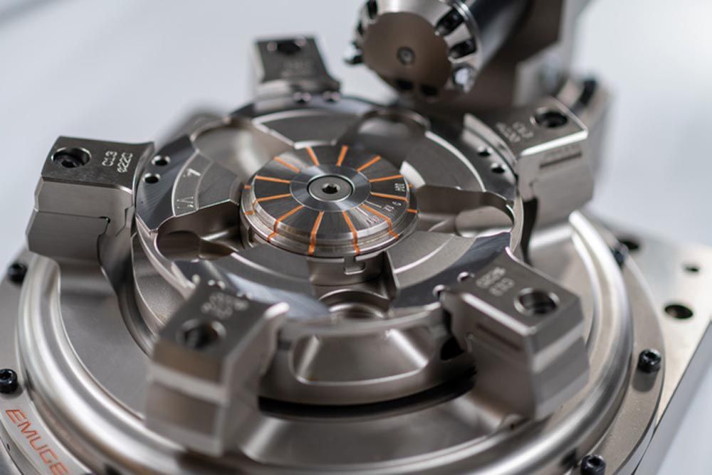

The external clamping concept forms a diaphragm. The five clamping jaws (3) are screwed to the diaphragm and rest against the workpiece due to its inherent tension. This torque is massively reinforced by hydraulic pressure. The orange slots of the collet (4) are clearly visible through the clamping jaws. The alignment unit (1) is located in an outboard position above two of the clamping jaws.

Designed with indicating in the base and jaws on a diaphragm for perfect runout correlation between the two.
Diaphragm clamping devices are able to achieve excellent concentricity or roundness in machining, even with finely detailed workpieces with strict tolerances. Accuracies in concentricity or roundness of 10 to 30 µm can be obtained, depending on how large and how thin-walled the workpiece is. And even though many diaphragm clamping devices are suitable for workpieces with a diameter of 5 to 20 in. (130 to 510 mm), a compact design is possible.
A clamping diaphragm has a high internal tension due to its design, so the forces adapt perfectly to the contour of the workpiece. For thin-walled workpieces, the clamping diaphragm is designed accordingly. The clamping force can be increased by the tractive force of the machine for robust workpieces.
Clamping jaws, which are a typical element of diaphragm devices, ensure that the workpiece is clamped securely, without deformation, and at defined points. An optional face clamping additionally clamps the workpiece. Six or eight clamping jaws are used depending on the clamping diameter. Also, the clamping force is independent of the rotational speed due to centrifugal force compensation.
