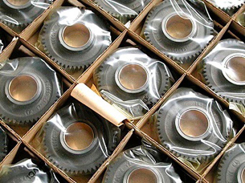

GT: Can a gear manufacturer tell if he has a problem before he receives customer complaints?
TW: Determining the presence of corrosion issues before receiving customer complaints is challenging for gear manufacturers. However, indicators can point towards potential problems, particularly if manufacturers are not adhering to stringent maintenance protocols for their metalworking fluids and are neglecting best packaging practices. Understanding the proper application of VCI technology is crucial for leveraging its full protective potential.
VCI products, available in forms such as poly bags, sheeting, kraft paper, diffusers, emitters, powders and liquids, release vapors containing corrosion inhibitors that form a protective barrier around metal surfaces. It’s essential that the VCI vapors remain contained within the packaging environment to be effective. This requires that bags are sealed properly, boxes are fully closed, and metal parts are completely encapsulated, preventing the escape of VCI into the atmosphere.
The effectiveness of VCI is maximized when applied to clean and dry, contamination-free metals. Unfortunately, it’s common for manufacturers to package parts without realizing they are contaminated with chlorides, bacteria or other corrosion-inducing ions, often due to fingerprint contamination, unclean workspaces, or inadequate maintenance of metalworking fluids. Moreover, for VCI to form an effective protective layer, metal parts must be fully dry before packaging. Packaging wet or damp parts can initiate the corrosion cycle before the VCI has the opportunity to act.
Another consideration is ensuring metal parts are at ambient room temperature before sealing the packaging to avoid condensation, which could lead to corrosion. This is also pertinent when unpacking metal parts, especially when transitioning from different environmental temperatures. Additionally, when configuring packaging materials, it’s crucial to avoid direct contact between metal parts and potential sources of moisture and acid, such as cardboard, non-VCI paper, or wood. Proper placement of dividers or interleave sheets is necessary to not obstruct the VCI’s path to the metal surfaces. In configurations involving layered or bulk packaging, additional VCI materials may be required to ensure each layer is protected.

TW: Utilizing deionized (DI) or reverse osmosis (RO) water for diluting metalworking fluids and wash chemistry is paramount, as it prevents the introduction of minerals and contaminants that can accelerate corrosion. Proper maintenance routines are essential, including accurate analysis of wash chemistry to ensure correct dilution and thorough cleaning. Effective washing, characterized by sufficient pressure to thoroughly clean parts, routine maintenance of nozzles to prevent clogging, and the use of appropriate temperatures, is crucial for removing contaminants.
Ensuring complete drying of parts is also critical; manufacturers should verify that parts are thoroughly dry, adjusting heat and drying time as necessary to prevent moisture retention. The handling of parts requires meticulous attention, with employees wearing clean and dry gloves to avoid transferring contaminants to the metal surfaces. When it comes to packaging, only clean and dry parts should be packed, with the parts’ temperature closely matching that of the room to prevent condensation. VCI packages should be securely sealed using tape, heat seals, zip ties, or by folding over, and resealed after every use to maintain integrity. For added protection, especially in larger or densely packed packages, the insertion of ZERUST VCI materials as interleave can offer additional protection against corrosion. Direct contact between metal parts and materials like wood, paper, or cardboard, which can introduce moisture and acidic conditions conducive to corrosion, should be avoided. By implementing these best practices, gear manufacturers can significantly reduce the risk of corrosion, ensuring that their products maintain their quality over time.
