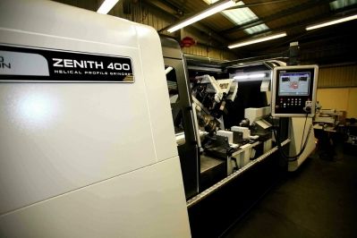

Launched at EMO Hannover 2011, Holroyd’s Zenith 400 helical profile grinder quickly caught the eye of screw compressor manufacturers seeking superior, ultra-precise grinding solutions.
Developed to precision grind components weighing up to 700 kg and measuring up to 420 mm in diameter and 2.2 meters in length, the Zenith 400 combines high stock removal rates and aggressive semi-finishing, with production rates and accuracies tailored to the most demanding of manufacturing strategies.
Holroyd’s Zenith 400 ultra-precise helical profile grinder has the capability to use aluminium oxide, ‘diamond hard’ plated Cubic Boron Nitride (CBN) and vitrified, dressable CBN grinding technologies – effectively providing roughing and finishing capabilities on one machine.
