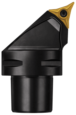

PrimeTurning is initially supported by the introduction of two dedicated CoroTurn Prime turning tools and the PrimeTurning code generator, which supplies optimized programming codes and techniques. CoroTurn Prime inserts have three edges/corners - one for longitudinal turning, one for facing and one for profiling - thus, delivering efficient edge utilization and longer tool life.
Two unique and dedicated inserts are offered: CoroTurn Prime A-type features three 35 degrees corners and is designed for light roughing, finishing and profiling, while CoroTurn Prime B-type, with its ultra-strong corners, is designed specifically for rough machining. Suitable for ISO P (steel), S (heat-resistant super alloys and titanium) and M (stainless steel) category materials, nine CoroTurn Prime A-type and six CoroTurn Prime B-type inserts are currently available, with expansion to other materials planned for the future. The inserts are supported by 52 variants of tool holders, including Coromant Capto, CoroTurn QS and shanks.
