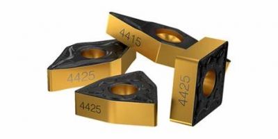

​​​​​​​Sandvik Coromant is upgrading its range of turning inserts for machining ISO-P steels. The tooling specialist has launched two carbide grades that are designed for external and internal machining of low-alloyed and unalloyed steels. The new inserts, called GC4415 and GC4425, deliver increased toughness, heat resistance and predictable wear.​
​​GC4415 and GC4425 are ideal for manufacturers operating in mass and batch production set-ups machining low alloyed (P 2.1 to 2.6) and unalloyed (P 1.1 to 1.5) steels, respectively.​
Grade GC4425 is shown to outperform competing inserts in a majority of steel turning applications. It features improved wear and heat resistance and toughness, which significantly expands the application range. Both it and GC4415 can be used for finishing to roughing, in applications with continuous cuts and light interruptions.
Meanwhile, GC4415 is designed to complement GC4425 when enhanced performance and more heat resistance is needed. In addition, the materials' new post-treatment is found to boost performance in intermittent cutting operations, avoiding any sudden breakages and enabling both insert grades to outperform over a broad application range.
