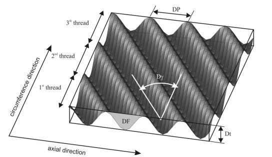

Hommel Etamic RoundscanLead angle is a periodical structure, both axially and circumferentially. Characterizing axial structure roughness requires the use of high-resolution measurement systems. Circumferential structure roughness can be characterized using significantly coarser systems because the frequency of the lead angle typically lies between a range of 0 and 180 waves per 360-degree rotation. This makes it acceptable to measure lead angle using a defined number of parallel roughness traces in an axial direction. Part clamping of the workpiece can have an influence on this type of measurement, which can be eliminated using special hardware or mathematical algorithms.
Lead angle issues exist in both turning and grinding operations, inevitably due to machine feed motions leading to a single thread-like surface structure who’s lead-gradient is determined by the rotary feed. During dressing of the grinding wheel, the dressing in-feed rate can create a helix on the surface of the grinding disc which is then transferred to the workpiece surface during actual grinding (this is subject to a ratio of the rotational velocities). This necessitates using the entire circumference of the workpiece in order to determine the lead angle structure (Twist Measurement). Since these helix-like structures (Lead Angle) caused by the manufacturing process can lead to an unacceptable amount of lubricant consumption, and possible failure of the entire assembly, it becomes even more critical to develop standardized methods by which the lead angle of these parts can be truly measured.

HE, being one of the co-developers of both the earlier first-generation and the newer second-generation standard (MBN 31007-07), has developed two measurement techniques designed to deliver the best measurement results possible. Twist and TwistLive have been optimized to perform actual lead angle measurement on parts manufactured during grinding or turning. Twist lead angle measurement consists of taking 72 separate roughness traces, 5 degrees apart, each trace exactly 2mm long with a sampling distance of 0.5um. This measuring process allows the actual measurement of lead angle, lead pitch, and lead depth along the entire circumference of the part. This is a time-intensive process, but allows not only the actual measurement of each of the parameters but allows the calculation of the volumetric area of the total surface area. Twist Live lead angle measurement considerably shortens the measurement time frame by only taking about 10 separate roughness traces, each trace exactly 2mm long with a sampling distance of 0.5um, and then extrapolating (predicting) the lead angle between each trace. This unique feature reduces the lead angle measurement time to 2 min from about 30 min.
