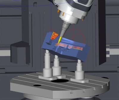

Resulting in simplified programming and increased process reliability, hyperMILL VIRTUAL Machining NC code-based machine simulation has also been enhanced. Within the VIRTUAL Machining Optimizer module which links individual part programs with smooth and safe connections, the cutter is able to remain close to the workpiece, violations of the axis limitations are now detected and movement sequences are optimized accordingly. There is also a new option in VIRTUAL Machining to apply a special approach and retract strategy to machines where the cutting tool can be retracted into a tunnel.
