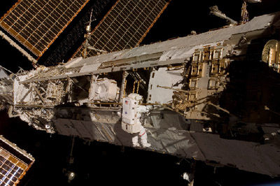

Shuttle Discovery flight engineer Daniel Tani during a more than 6-hour spacewalk dedicated in part to an inspection of the International Space Station’s malfunctioning Solar Alpha Rotary Joint (SARJ). Tani returned to the station with metal “shavings,” samples of an as yet unknown origin gleaned from beneath the joint’s multi-layered insulation covers.

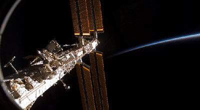

Since last October, NASA engineers on the ground, as well as International Space Station (ISS) and shuttle Discovery astronauts, have been working to indentify and rectify an ongoing problem with one of the two solar array panels that power the station’s energy system. The area of concern is one panel’s two 10-foot-wide bull gears, fitted with two redundant-drive motors, or drivelock assemblies (DLA). Together, they comprise one SARJ—or solar alpha rotary joint—in the power truss that serves to direct the massive starboard solar panels towards the sun. Only one DLA is needed at any time to power the outboard bull gear. The other panel is problem-free. While at this writing a root cause remains elusive, the problem does not present any imminent danger to the crew or station, according to NASA. That’s because despite what NASA SARJ recovery team leader Kevin Window characterizes as a “major anomaly,” both solar panels can still be maneuvered, if necessary. In other words, the motor and/or bearings that power the panel in question have not seized and are therefore operational, if only manually for the time being.
After ruling out possible meteor damage, the investigation continues both in space and on the ground at the Johnson Space Center (JSC) facility in Houston. ISS station commander Peggy Whitson and flight engineer Daniel Tani, along with lead and fellow spacewalkers Scott Parazynski and Doug Wheelock, respectively, have led the space-borne investigation while Window coordinates earthbound testing.
Bad vibes a concern. Flight control first became aware there was a problem when ground personnel noticed unwarranted vibration during the affected panel’s rotation. A surge in the panel’s power mechanism was also detected. As a result, space walks and other activities planned for the ISS and Discovery crews were put on hold until it was determined that the problem was not life-threatening. Subsequent inspections by crew members ultimately revealed the presence of an unidentified grit—believed to be metal shavings—in the 12-set, trundle bearings gear race. Using swatches of tape, samples were collected from the surface by astronaut Tani. According to NASA, the debris could be causing the power surge which, if not controlled, can cause major damage to the SARJ unit. The samples were delivered to JSC courtesy of the Discovery STS-120 crew upon their recent return to Earth on November 7.
