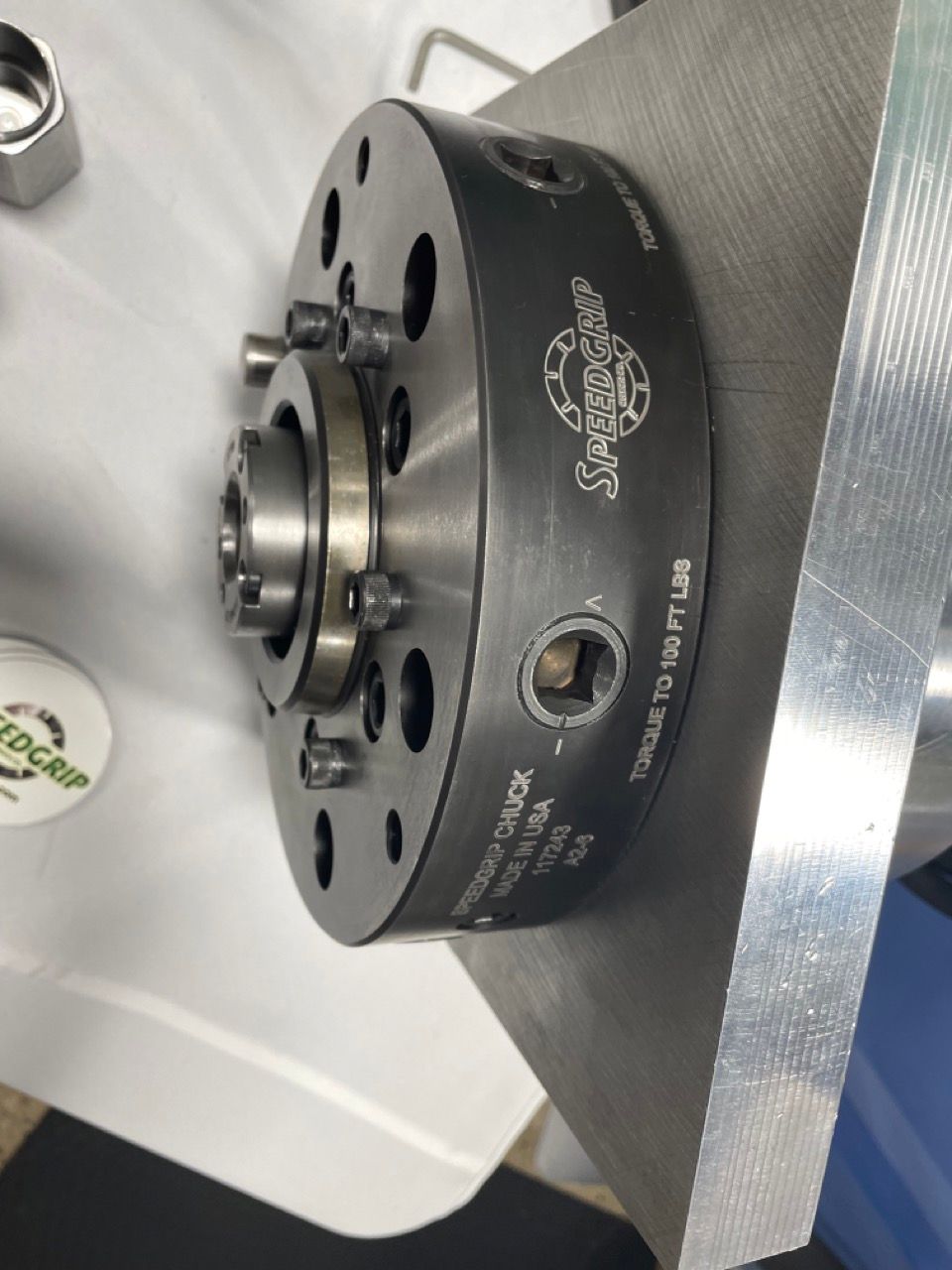

As a portfolio company of Stratford-Cambridge Group, Speedgrip Chuck Company provides manufacturers the means to improve efficiency and productivity by reducing cycle times while featuring affordability and durability. For versatility and efficiency, the NDS Quick-Change Mandrel uses a unique rear bayonet mount that pulls and secures the workholding collet from behind, eliminating the need for draw screws. The no-draw-screw (NDS) configuration improves workpiece accessibility to quickly and efficiently combine outer diameter (OD) and inner diameter (ID) turning, facing and grinding into one operation with minimal interference.
Speedgrip’s patented one-piece sealed collet design outperforms the competition and does not break down with extended use under harsh machining coolants. As the most advanced workholding solution currently available, the NDS Quick-Change Mandrel allows for faster spindle speeds without loss of gripping power due to centrifugal force while significantly extending durability and service life.
The NDS Quick-Change Mandrel is highly adjustable with steering screws to compensate for total indicated runout and concentricity, providing repeatable accuracy to 0.0003 of an inch. The unit is available in seven standard sizes ranging from 0.5 to 5 inches for all standard spindle nose configurations and custom sizes are available upon request.
Speedgrip’s revolutionary QCR Quick-Change Receiver is a manually actuated cam-lock receiving plate that attaches to CNC Lathe spindles and dramatically reduces the time needed to change workholding clamping devices. With the QCR Quick-Change Receiver, the time needed for operators to effortlessly switch ID/OD collets, jaw chucks or face driver workholding devices on their machines is cut from an hour to five minutes, making them well suited for just-in-time production. Similar to tool retention in the spindle, the QCR has automatic release of the draw connections.
