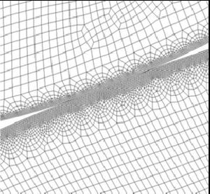

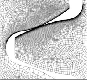

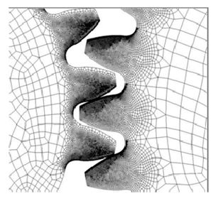

The FEA was conducted on the same gear pair using a commercially available software package, MSC.MARC. The gears were modeled as two discs with four teeth each, under plain strain conditions. 80,000 first-order quads were used, with mesh re­finements in the tooth and at the surfaces in order to also capture contact stresses (Figs. 1, 2 and 3). Linear elastic modeling was used for the initial runs.

Figure 2—Mesh refinement.
Figure 3—Mesh refinement for contact stresses.

The deflection of the loaded tooth on the plastic driven gear is the cause of this skewed load share curve. As the loaded tooth is deflected, the rotation­al angle of meshing is moved out of phase, thus causing both preliminary contact by the next tooth entering mesh and prolonged contact at the end of mesh by the preceding tooth. That preceding tooth is being unloaded and is straightening back to its undeflected form (Fig. 5).
Figure 5—Deformed mesh.

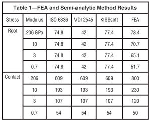

This increased contact—both entering and leaving mesh—will increase load sharing and thus lower the root stresses. Table 1 shows the results given by the FEA and semi-analytic methods. You can see the effect—as the modulus decreases, the FEA shows the actual stress decrease. The difference between the theoretical and actual (FEA) also be­comes more significant. While most semi-analytic approaches allow no dependency for root bending stresses on modulus, the FEA shows there is in­deed an effect of tooth deflection, which is indirectly dependent on modulus.
