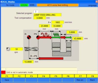

The objective of this new development was the integration of the latest servo drive and control technology from Bosch Rexroth. Software developed additionally allows the user to program six different basic cycles without prior knowledge of CNC.
By visualizing these six cycles - drilling, combined drilling (drilling and thread cutting with the one tool), thread cutting, drilling with chip removal, drilling with jump function and undercutting - the unit has become extremely easy to program.
Plus, should the required machining cycle not be found among the standard selections or prove more complex, the unit can be switched to sentence programming.
