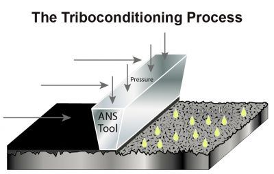

Triboconditioning is a combined mechano-chemical surface treatment process which uses a machining procedure to level off surface peaks and apply a friction- and wear-reducing compound to the component surface. Unlike spray coatings, the compound becomes an integrated part of the component structure at a nano level. The process is mechanically simple and, in most cases, can be done with Sunnen precision honing equipment. It is very cost-efficient in mass production environments, making it perfect for in-house manufacturing as a part of component manufacturers’ production lines.
