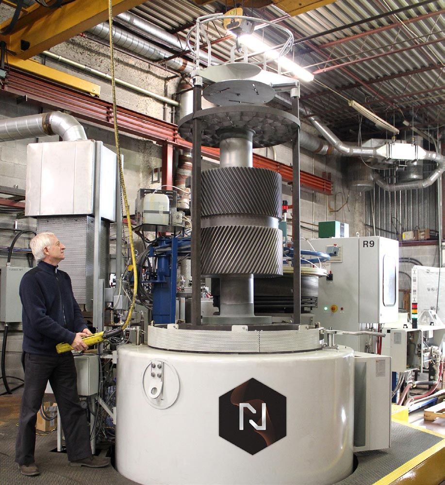

Nitrex showcased its strength in thermal processing from turnkey heat-treating systems to process control solutions, software/digitalization, and heat-treating services at FNA 2022.
Nitrex revolutionized controlled gas nitriding with NITREG over 40 years ago, and they continue to be at the forefront of this surface hardening technology today. Nitriding and its derivative processes, such as ferritic nitrocarburizing, as well as other special processes for nitriding stainless steels, are the most rapidly expanding processes for the surface hardening of gears.
Nitrex works with gear manufacturers from all over the world, assisting with prototyping to process development, low- to high-volume heat treat orders, and new in-house, high-volume installations as well as retrofit applications. These end-to-end solutions deliver superior quality by improving the durability and performance of gears as well as the efficiency and simplicity of gear manufacturing operations.
When it comes to improved gear performance, Nitrex’s controlled NITREG controlled nitriding, NITREG-C controlled nitrocarburizing, and NITREG-S controlled nitriding of stainless steels with its inherent low-temperature processing, are highly beneficial to the automotive, aerospace, defense, mining, and many other industries. Here are some key benefits:
  • Optimum and consistent gear properties
  • Improvement of gear tribological properties
  • Best alternative to eliminate gear distortion (noise reduction)
  • Cost-effectiveness by eliminating or reducing several finishing operations, including washing, inspection, hard finish machining, etc.
  • Similar bending stress limits and contact fatigue resistance to carburizing
  • Environmentally friendly

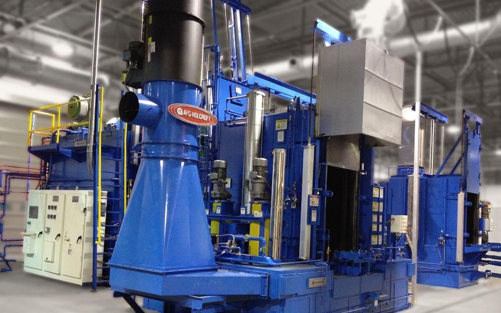

AFC-Holcroft
PHOTO CREDIT: AFC-HOLCROFT UBQA
AFC-Holcroft was proud to once again exhibit at FNA. This specialized industry event is considered the opportunity for manufacturers—across diverse industries who utilize heat treatment in their production—to learn more about solutions that may be relevant to their unique metallurgical challenges.
Although AFC-Holcroft offers several thermal technologies suitable for the production of gears, one product worthy of a special attention is the UBQA (Universal Batch Quench Austemper) furnace.
While best known for austempering of steel, the UBQA is capable of a number of metallurgical processes including neutral hardening, carburizing, carbo austempering, marquenching, and austempered ductile iron (ADI).
Austempering is unique in its ability to control distortion and the associated costs of machining. AFC-Holcroft’s exclusive water injection system can provide quench severities similar to a water quench and can through harden up to 6-inch (152mm) thick cross sections. The UBQA uses molten salt as a quench medium, which when outfitted with a salt reclamation system allows for over 98 percent recovery of the salt. And the residual waste can typically be disposed of in municipal drains without the need for special permits or methods. The industrial manufacturer seeking a greener alternative would be well served to give this proven design some serious consideration and to inquire about possible cost savings in disposal and salt investment.
In addition, the UBQA design is not limited to gas heating—it is also available as electrically heated, allowing the customer to utilize green-energy options that may be available in their area, such as solar, hydroelectric, and wind.
The UBQA is modular in design, which allows for flexibility in the layout of the furnace itself and its companion equipment. A flexible production cell can be far more accommodating for fluctuations in production volumes, and easier expansion capability for future installations. Several standard size furnaces are offered, and customization is available to meet specific customer requirements.
But the UBQA is not AFC-Holcroft’s only product that gear manufacturers may find of interest. Consistently high production volumes may make consideration of a single or multi-row pusher furnace a more cost-effective option in some facilities. Or an AFC-Holcroft rotary hearth furnace for preheating and press quench may be more suitable. There is no one-size fits all option—and that’s where their furnace experts can help.
