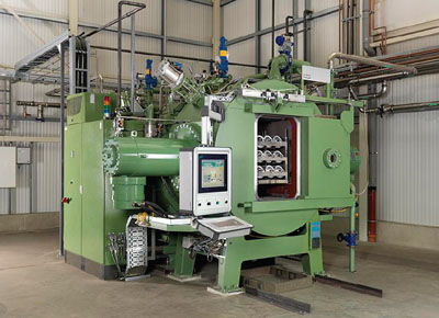

“Our electrically heated, low-pressure carburizing furnaces produce significantly less greenhouse gases than the traditional method of carburizing in atmosphere-based furnaces,” says William Gornicki, vice president of sales and marketing at ALD-Holcroft. “Traditionally, high volumes of carburized components could most cost efficiently be processed in big, atmosphere furnaces. These types of furnaces are less capital intense. However, the vacuum capabilities now on the market are making that argument less effective.”
This Dualtherm 2-Chamber, LPC/HPGQ, from ALD-Holcroft produces less greenhouse gases.
By minimizing or even eliminating downstream operations like straigh-tening or post heat machining, significant costs are removed from the manufacturing structure. “A far more uniform case depth is possible with vacuum carburizing. This most often provides higher power densities enabling smaller or lighter components with the same capabilities,” Gornicki says.

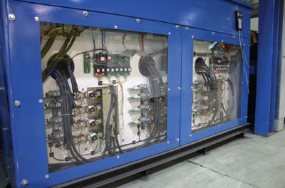

Solar, with the help of its subsidiary, Magnetic Specialties, Inc., has devel-oped a power supply called the FCS 2000 that runs more efficiently than the industry standard power supply from 5 to 20 percent. This improved efficiency is partly due to the fact that the FCS is a “dry” power supply and uses no cooling water to maintain the required operating temperatures.
“The power supply saves money for those who are being charged a power factor penalty from the utility company because the FCS runs at unity power factor,” Jones says.
