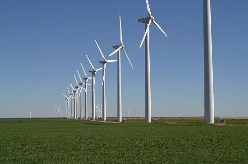

Behemoths like this Clipper Windpower 100MW Endeavor (left) turbine installation in Iowa and the 2.5MW Liberty—the largest in the U.S.—require like-sized components, particularly gearboxes, rotors and bearings. Photos courtesy Clipper Windpower.

This look at the 330,000 sq. ft. Clipper Windpower plant in Cedar Rapids, Iowa provides a sense of proportion relative to the space requirements necessary for component production and assembly. Photo courtesy of Clipper Windpower.

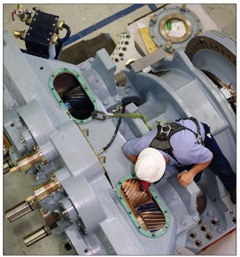

The gearboxes and gears used in today’s wind turbines are some of the most technologically advanced in the world. Finding skilled designers and workers to make them continues to be a problem for the industry. Photo courtesy of Clipper Windpower.
Charlie Fischer, VP/Technical for AGMA, points out that “Because of the size and wind turbine stipulations on a gear drive of this type, you have to have high-power-density gearing in them, which leads to having a good handle on the material used in the gear elements and the manufacture of them. And these are things that slow down the process.”
Going to the source. If you can find one. Patrick O’Keefe is a CA-based, global sourcing and component buyer for Mitsubishi Power Systems America (MPSA). As one in the front trenches of the supply chain battle, he brings particular insight to the problems and possible solutions facing turbine manufacturers. And while following his recommendations may be beyond the reach of the smaller suppliers, they nevertheless ring true.
“Manufacturers need to invest in the large gear grinding equipment, on-site heat treating and testing equipment,” he says. “If a supplier can handle most of these functions in-house, then they are valuable to the industry. There are some leaders and some followers that know what needs to be done, but the decision has to be made now for investment and expansion to meet the demands of wind.”
