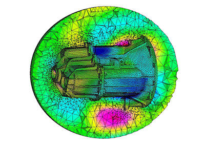

Figure 1 Acoustic radiation predicted using results generated by RomaxDesigner.
- Click image to enlarge
Whilst the sophistication and accuracy of these tools are not in question, the fact that many calculations are made without considering the effects of the entire system can lead to later problems during the manufacturing process, which in turn can prove incredibly time consuming and expensive to correct. For example, powertrain noise and vibration issues might go undetected until the first hardware prototypes have been tested.
The transfer of data (or lack thereof) between different design and analysis tools can compound the problem. In some cases, basic concept design changes can take weeks to ripple through various departments, often requiring manual updating of models, which is both slow and error prone. This can be a major hindrance to the creation of optimal, cost-effective designs.
Component-level software tools have traditionally been unable to provide the over-arching systemlevel analysis needed within modern integrated design approaches. Many manufacturers recognize that this critical issue needs to be addressed, but when it comes to implementing a strategy to achieve this, it can be a case of “easier said than done.”

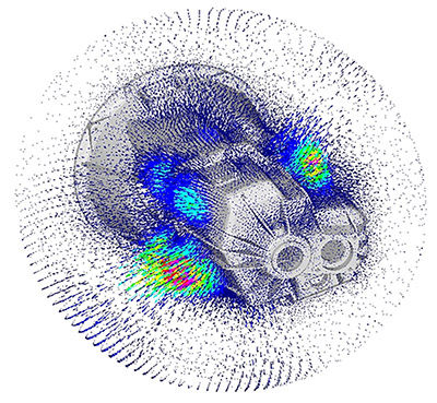

Figure 2 Acoustic radiation predicted using results generated by RomaxDesigner.

While the automotive sector has made steps toward improving NVH — thanks to improvements across design, analysis, development and manufacturing processes — challenges still exist for the hybrid and electric vehicles sector. EV and HEV design is altogether a more complex process than designing traditional drivetrains; EVs do not benefit from the “masking” effect of the noise from internal combustion engines, while HEVs represent a particular challenge because vibrations from both the engine and the motor must be considered, along with the interactions between them.
In order to address this, simulation needs to be at the forefront when trying to reduce NVH. Many manufacturers work with finite element analysis and multibody dynamics tools that try to predict vibration response of the drivetrain system. However, these processes can prove to be so time-consuming that they’re often only used too late in the design process for the problems to be resolved.
If manufacturers have access to software that can simulate different solutions in the earliest design phase before they are produced, organizations can save vast amounts of cost and time. To support this it is important to ensure companies have the right CAE tools and development processes in place.

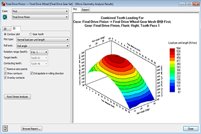

GKN Driveline has applied Romax Technology software and consulting to focus the optimization of gearbox efficiency in electric motor-driven transmissions without compromising noise and durability.
After identifying the main contributors to power loss, investigating how changes to macro- and micro-geometry would affect efficiency, and optimizing the geared system in RomaxDesigner, GKN Driveline manufactured the resulting gears and evaluated experimentally the driveline efficiency. Results showed improvements across the speed and torque range of interest of up to 2 percent without compromising on durability and NVH. This provided valuable insights into how GKN Driveline continuously initiates performance improvements in its customer applications.
Figure 3 Tooth contact in RomaxDesigner.

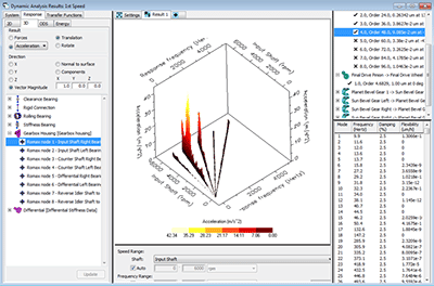

Figure 4 Vibration response calculation in RomaxDesigner
Gassmann says transmission issues for EV and HEV are broadly similar to nonelectric applications: “Powertrain efficiency, durability and NVH. Differences come regarding the duty cycle and loads, between coast and drive. The driveline is different. And when you have to invest in battery capacity, you don’t want to waste energy in the transmission. The biggest challenge is arguably NVH. Missing masking noise from combustion engine and lightweight-design leads to an early focus on NVH improvements.”
