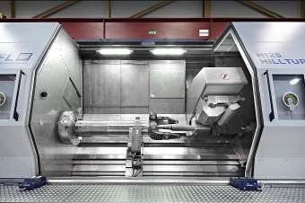

Heavy duty cutting places particular requirements on the machine and working processes. If this involves a material such as titanium, which is particularly hard to cut, specific know-how is necessary to deal with these requirements. Thanks to its expertise, WFL Millturn Technologies GmbH & Co. KG impresses in this field with a machining solution for aircraft landing gear.

Materials which are hard to cut like titanium have influenced the development of the WFL machines. WFL provides individual solutions for exactly these kind of demanding applications. These also cover aspects such as cooling and production strategy as well as the actual machine.
"In order to be able to offer WFL customers reliable solutions, WFL has developed components which make it possible for us to match the design of the machine precisely to the relevant application case." – Reinhard Koll, Head of Application Engineering WFL.
