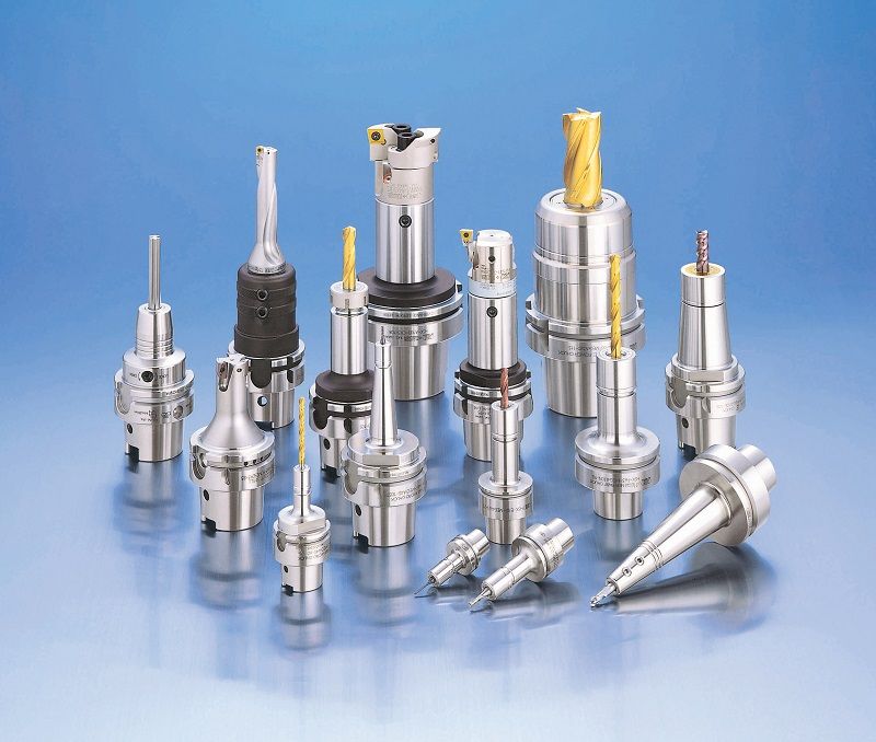

Machining speed, besides depending on the physical limitations of the machine tool and cutting tool, will largely be governed on how well balanced the tool holder is. Balance is usually the focus when talking about high-speed tool holders because it offers the greatest opportunity for improvement, but keep in mind the maximum speed will only be as fast as the “weakest link” allows. If you have a 12,000 rpm spindle, inserts that allow cutting at 9,000 rpm, but the tool holder is only balanced for 8,000 rpm, then 8,000 is the max rpm.
The faster you spin, the more exaggerated mass irregularities become, and speed harmonics present in the system will become increasingly excited. This translates into vibrations which, in turn, cause poor runout, surface finish, scrapped parts and equipment damage. Symmetry is your best friend at high speeds.
Shrink fit holders, hydraulic chucks and high-performance collet chucks are typically the best examples of well-balanced tool holders because, by design, they’re symmetrical. They’re also generally slim – most of the mass is concentrated near their centerline.

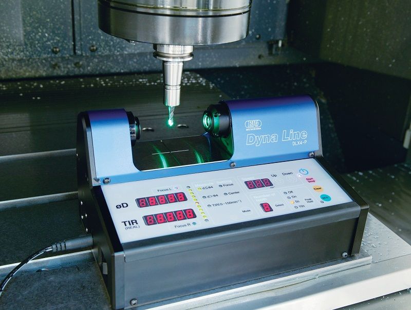

When it comes to fine boring tools, balancing can be a serious issue. Single-point finish boring heads are fundamentally unbalanced because of asymmetry, and special care is required to ensure they perform as expected. To say bores are tolerance-sensitive is an understatement; this unbalance can easily scrap a part.
Running a boring head as fast as it can go should always be the goal, however, unbalance can be introduced to the system. An unbalanced boring head can be deceptive because it will frequently bore your diameter within spec. Yet, upon further inspection, you will find an oval-shaped bore rather than a circle-shaped one.
Circularity/cylindricity is a common GD&T (geometric dimensioning and tolerancing) callout for shafts and holes, so boring head balance is crucial for those situations. At the very least, standard boring heads are usually pre-balanced for a diameter somewhat near the middle of their diameter range. If it’s a rigid, reasonably short bore, this will suffice.
When higher speeds and longer boring bars are needed, consider auto-balancing heads. These heads are well-balanced throughout their diameter range; the head that automatically adjusts a counterweight as the diameter is adjusted.

Equally important as the tool holder body is the taper. In most cases, you’re stuck with the machine spindle taper you have. But, if contemplating a new machine, consider one with an HSK spindle.
HSK combats problems that conventional steep tapers encounter at high speeds. The spindle taper expands more than the holder under high centrifugal force because of differences in stiffness, which causes the tool to “sink” in the Z-axis. The drawbar fingers go inside of the thin-walled taper and expand outward to clamp. Unlike steep tapers, high speeds aid the clamping mechanism and proper seating.
HSK holders have flange contact in addition to taper contact as part of the standard. This eliminates the dreaded sinking phenomenon. Past 35,000-40,000 rpm, an HSK spindle becomes one of the only options.
Additionally, alleviate unwanted Z-axis movement with BIG-PLUS tooling, which is the same flange contact principle applied to steep taper holders like CAT or BT. You also will see huge gains in rigidity, given you have a BIG-PLUS spindle.
Exploring a new frontier
Ideally, keep the mass of the tool holder as close to the centerline of rotation as possible, and keep the tool as short as possible. This is the reason why there is general trend of higher maximum speed the smaller the tool holder is. You simply don’t have much mass to throw around, so a higher speed can be attained safely. HSK-E style tool holders take this principle to the extreme.
In addition to having an HSK taper that’s well-suited to higher speeds, it aims to be as close to perfectly symmetrical as possible by the removal of notches and drive key slots. These are commonly used in conjunction with very small diameter tools in order to reach ridiculously fast speeds. It’s not unheard of to achieve upwards of 50,000 rpm in some applications. The only catch is you are using very small tools.
