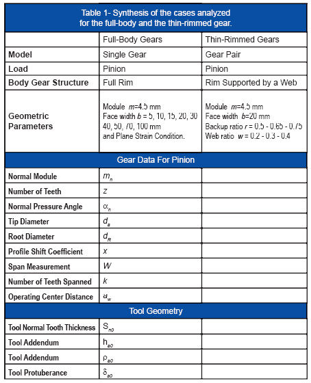

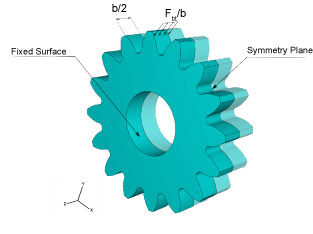

This study examines the bending stress along the tooth width for a fixed geometry and for different values of face width (Table 1). To begin, the case of an error-free spur gear pair with full body was considered. In the FEM analyses, only half of the pinion was modeled, since loading conditions and geometry are symmetrical to the middle plane of the gear width (Fig. 1). The load, applied at the highest point of single tooth contact (HPSTC), was modeled as a linear force uniformly distributed along the face width and perpendicular to the tooth surface. The hub of the pinion was fixed (Fig. 1). An example of the FE models used in the analyses is shown in Figure 2.
Figure 1--Geometric model and boundary conditions: Full-body gear.
Figure 2--Finite Element Model: Full-body gear.

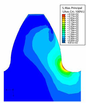

Even with uniform load along the face width, numerical results show that there are areas with different stress levels at the tooth root (Figs. 3 and 4). For values of the ratio b/m between the face width and the module commonly used in practical gear design, the stress level is higher in the middle of the gear width than in the side areas. In the center cross-section, the magnitude of the maximum principal stress is higher than on the sides of the gear, and an intermediate principal stress is present. In addition, the location of the highest value of the maximum principal stress in each cross-section changes along the face width, but the range is small. The location varies from 30° in the middle cross-section to 34° on the sides (Figs. 5 and 6) if the position in the tooth root fillet is described by the angle ψ, the angle between the symmetry line of the tooth and the tangent to the fillet curve.
Figure 3--Maximum principal stress contour plot in the middle cross-section: Full-body gear with b = 20 mm.

A model of a spur gear pair is used here to evaluate the influence of both the rim and web thickness. In the geometrical model, the gear bodies are modeled as a thin rim supported by a web (Fig. 9). Nine different case studies are analyzed with all geometry parameters fixed, excepting the back-up ratio and the web thickness ratio (Table 1). The first, here referred to as r, is the ratio between the rim thickness SR and the tooth height. The second, referred to as w, is the ratio between the web thickness bS and the face width b.

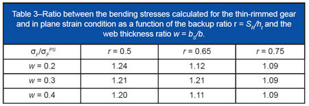

The values of the YB factor calculated for r = 0.5, 0.65 and 0.75 are listed in Table 2, while the ratio between bending stress for the full-body gear and the thin-rimmed gears investigated in this study are reported in Table 3. The differences between the values for a given r are large, but the effect of web is not taken into account in the YB factor. The values obtained have instead a good correlation with the results of numerical and experimental investigations described in Reference 5, where the effect of both the thin rim and the web thickness are considered.
