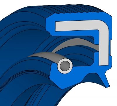

Oil seals play an essential role in any gearbox. They are used to seal rotating shafts to prevent oil leaks and protect the system against external contamination. Oil seals basically consist of three elements: A metal insert gives the seal its shape. The rubber material enables the sealing functionality, typically the elastomer outer diameter that provides a static sealing effect for housing bores and the main sealing lip that provides a dynamic sealing on the rotating shaft and is in direct contact with lubricant in the gearbox. A garter spring supports the main sealing lip to ensure the radial force on the shaft.
For applications to counter dust and dirt exposure oil seals are available with a protective lip in contact with the shaft surface. When the gearbox is functioning, the pumping action of the gears ensures effective lubrication and lubricant exchange in the gear meshing area. Damage or wear to the main oil seal can lead to oil leaks and consequent contamination.
