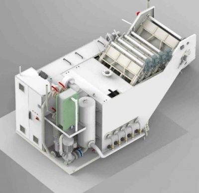

Vomat Releases UBF Filtration System
The Vomat UBF concept is a vacuum band filter equipped to handle a wide variety of sludge materials, such as ceramic, HSS, brass, aluminum oxide, disc abrasion and more. It operates with oil as well as water-miscible coolants. If necessary, it can be combined with a Vomat fine filtration unit. It is currently available in three sizes with the following filtration capacities: 110 Gal./Min., 264 Gal./Min. and 528 Gal./Min. As with all Vomat designs, the UBF system has a small footprint for its capacity. Vomat filtration systems are distributed by Oelheld in the United States.
