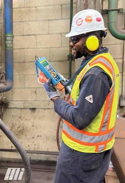

Steam systems are commonly used in manufacturing, food refining and meat processing. Like compressed air, steam is expensive to produce, and leaks are difficult to detect. Steam is crucial to cleaning and various processes, such as pasteurization, where the quality of steam is vital. Pure steam cools as it progresses from boilers to the intended point of use, forming a mix of condensate and gases. To maintain steam purity, steam traps are installed to capture and remove the condensate and waste that accumulate in the system. These traps are intended to modulate automatically, discharging condensate as it is formed to ensure consistent purity and efficiency throughout the system. However, steam traps with moving parts are failure-prone, potentially leading to up to 30 percent of waste in the system.
Ultrasound technology, capable of measuring turbulent flow even through thick pipe walls, can effectively monitor the progression of steam throughout the system. As steam travels turbulently through the pipes, an ultrasound device can—under normal conditions—“hear” the movement of the steam, providing valuable insights into its flow and behavior (Figure 2).
When a steam trap fails, the valve can be stuck in the closed or open position, or it might flutter between the two. Each condition produces different ultrasonic signatures around the 25 kHz range. By simply pointing the directional device toward the steam trap and surrounding lines, you can listen for signs of turbulent flow. If the flow is nonexistent or cycling rapidly, it indicates that the team must replace or repair the trap.
