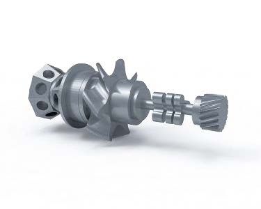

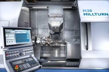

A significant aspect in the production of rotors is the complete machining of the workpieces. Rotors are machined from the saw-cut section, forged or cast part in a single operation in the Millturn. The workpiece is then clamped in a vice for end machining. During turning and milling operations, the rotor is clamped between the tip and the chuck with retractable jaws, allowing the highest levels of runout accuracy and quality to be achieved.
The M30 Millturn is also able to scan these rotor profiles. Without unclamping the workpiece, the milled profile is scanned over the entire circumference. The form cutters are automatically corrected after the measurement cut, so that in the final cut machining qualities are achieved that come very close to the grinding quality. With this innovative method of rotor scanning, you are able to detect shape deviations in the machine. The advantages include early detection of errors, maximum precision and security, and minimized downtimes. Experience live machining of a roots rotor at the WFL booth!
