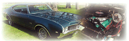

In the late ’60s, the "gearhead" lunch table at my high school spent several months discussing a classmate’s effort to "blueprint" the motor in his already powerful Oldsmobile 442. My childhood service as "bolt bucket boy" while my dad attempted to rebuild the family station wagon left me questioning the wisdom of taking apart a functioning muscle car to obtain a few more horsepower, but I was in the minority at the lunch table.
Articles in the various hot rod magazines we memorized spoke of optimizing cylinder wall clearances and improving surface finishes as if the benefits of such work were common knowledge. Many of us were taking drafting classes at the time, but the entire concept of "tolerancing" dimensions had yet to be introduced. I don’t remember it ever coming up in engineering school either.
Two things brought this memory to mind recently. First there was the photo of an Olds 442 on a muscle car calendar popular in our shop. Then there was the study in the Oct. 5 edition of Design News showing a certain Asian car with 127,000 miles to be "more reliable" than a brand new European luxury model. As it was generally acknowledged that the individual part quality of the European car was the best in the world, the study had lots of explaining to do. Almost as much explaining as the average quality engineer does when proposing a sizeable investment in non-chip-making assets at a gear company. This got me thinking about how engineers establish an appropriate tolerance for a specific feature on a part. How do we know what is "good enough" and what is "scrap"?
