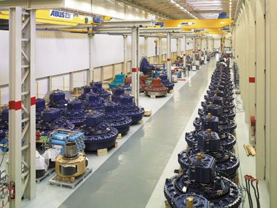

Photo courtesy of Hansen Transmissions

Hansen Transmissions manufactures complete wind turbine gearboxes and built a new factory dedicated to making them. According to Brems, the factory performs all the processes for manufacturing wind turbine gearboxes, including heat treatment of all the gears, except for one--the large internal ring gear: "The nitriding of the ring gears is the only process we outsource."
The factory also includes two 4.5-megawatt test stands for running the gearboxes under full load. Brems says Hansen is adding another 4.5-megawatt test stand and is building a 13-megawatt test stand, for both production testing and for research & development.
"We have spent $125 million dollars to build such a factory," Brems says. "On the one end, we bring in raw material, and on the other end, we ship out completely manufactured and tested wind turbine gearboxes."
