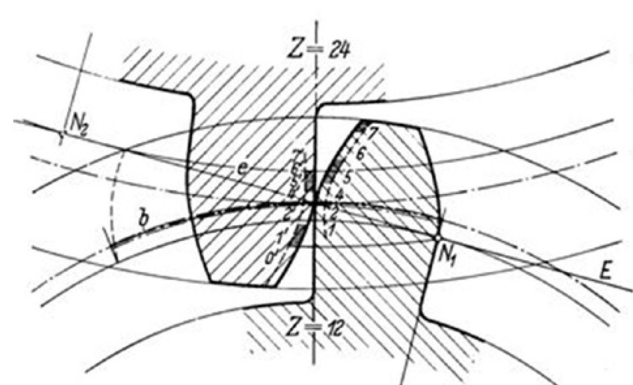

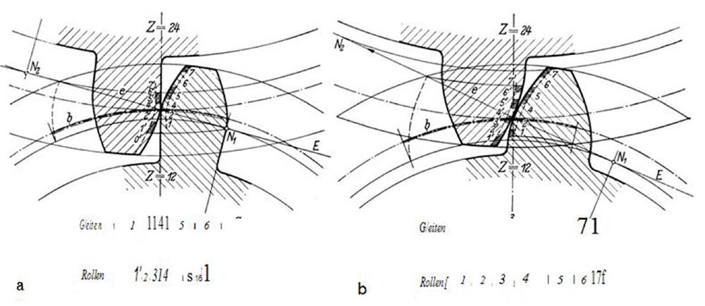

In the lecture, Maag described the MAAG Tooth System and explained its advantages presented in Figure 1.
The teeth according to the left side of Figure 1, which Maag called “normal teeth,” are made by a milling cutter, whereas the right image shows teeth made according to MAAG’s method.
gt0723_Page_54_Image_0001.jpgFigure 1—Teeth form cut by a milling cutter (left) and teeth generated by a rack cutter (right).
The most obvious difference lies in the different tooth thicknesses. In the case of normal gearing, the tooth thickness at the pitch circle is always equal to half the pitch. However, since the involute root lengths are very close to the pitch circles and the root profile is inside the base circles and runs radially, the tooth thickness in the root circles, i.e., at the steepest point of the highest stress, is always the smallest and even smaller on the pinion tooth that is subjected to the most frequent stress. The right of Figure 1 shows that the conditions are much more favorable in that the tooth thickness is greatest at the root and is somewhat larger on the pinion tooth than on the wheel tooth. The shape of the teeth offers the greatest possible resistance to fracture.
Because the root profiles on the left in Figure 1 are formed almost entirely by the radial extensions, they have no value for the transmission of motion. In addition, a large portion at the top of the wheel tooth is completely useless since it makes no contact on the short portion of the root profile of the pinion tooth. When the teeth engage, only very short portions of the profile make contact, which are correspondingly heavily stressed. In contrast to this, the image on the right in Figure 1 shows the active profiles of the MAAG teeth are very long and reach from the tip to near the root circles. Almost the entire profile takes part in the transmission of movement, so that the contact is distributed over much larger portions than with the normal teeth shown on the left image in Figure 1. Because of the large differences in length of the profiles that work together, this is mainly sliding in the case of normal gearing, whereas in the more balanced conditions in the case of MAAG gearing it is predominantly rolling. This is the reason for the significantly lower and equal slide to roll ratios, more moderate wear, and better efficiency of the MAAG gearing.
Finally, the lower profile curvature is less on the MAAG gears, which have approximately twice as large profile radii as those of normal teeth, which means that the resulting lower contact stress allows far higher loads on the gear teeth. These fundamental differences have been achieved by the simple means of appropriately selecting the outside diameter and the pressure angle. Theoretically, this was of course known for a long time, but in practice it was only made possible by using the advantages offered by MAAG’s manufacturing process.
