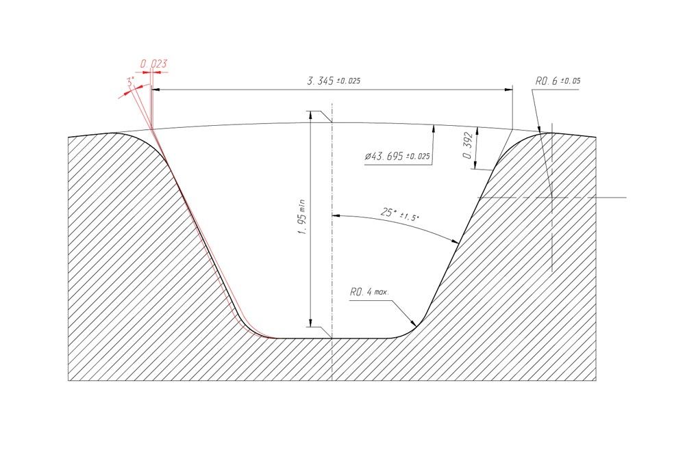

As the number of teeth to be considered first are 25 and 30, a T5 28-tooth pulley profile has been selected from the ISO 17396:2017 standard, and is shown here (in millimeters):
The specified flank angle tolerance is ±1.5 degrees. If constant gap width at points where straight flank lines end and rounding R0.6 mm begins was maintained, changing the flank angle within that tolerance produces changes of specified gap width 3.345 mm. The magnitude of these changes for each side is of the same order as the gap width tolerance (Figure 1—details drawn red). Furthermore, the specified gap width is dependent also on the tolerance of major diameter ϕ43.695 mm. To address problems resulting from these changes, it has been assumed that nominal values in the middle of respective tolerances will be used within the scope of this paper.
Figure 1—Geometry of a T5 28-tooth pulley.
The generating tool could machine the major diameter of the pulley. In such a case the tolerances on the major diameter would limit the possible positions of the generating tool. To keep the generating tool’s design as flexible as possible it has been assumed that the major diameter would be machined during the manufacture of the blank, and the generating tool would only machine the tooth gaps.
The tolerance of rounding R0.6 mm is specified two times wider than the tolerance of the major diameter, and the generating tool would machine this rounding. Even when the radius of rounding is kept within that tolerance, as the number of teeth generated on a pulley with a fixed reference profile changes, the radial height of rounding would also change. A generating tool could be designed to achieve a perfect transition of rounding into major diameter for one chosen number of teeth. Since different numbers of teeth are to be generated with that tool, it has been assumed in this paper that the radial height of rounding R0.6 mm (with a nominal value equal to 0.392 mm) must be monitored and maintained within the same tolerance as specified for the radius of rounding (±0.05 mm).

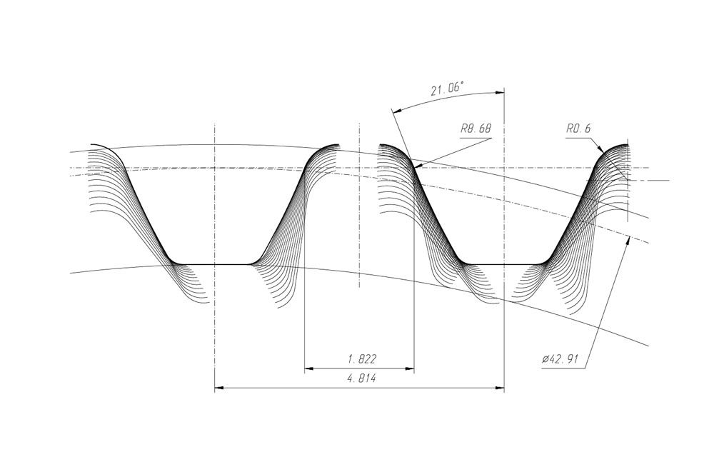

Reference Profile of Generating Tool
A reference profile of generating tool for a T5 28-tooth pulley has been obtained, using methods described in Refs. 2, 3, 4:
The local curvature of the reference profile at the point where rounding R0.6 ends and generating of flank begins is measured 8.68 mm, and the profile angle at that point is measured 21.06 degrees. When a small section of the profile is isolated, its deviation from a straight line is small enough to assume that it will shape an involute of a circle. In this study, a section with a length of 0.000536 mm (0.0005 mm high) has been used with a deviation from a straight line d calculated from Equation 1 as 4.1E-09 mm.

The circular tooth thickness on pitch diameter for a 28-tooth pulley, generated with a reference profile shown on Figure 2, can be measured straight on the profile as no profile shift is required to achieve the required gap width of 3.345 mm. This circular tooth thickness is measured at 1.822 mm. When the number of teeth on the pulley is other than 28, the reference profile would also be different, but since the reference profile for 28 teeth will be used, profile shift needs to be applied to achieve the required gap width.

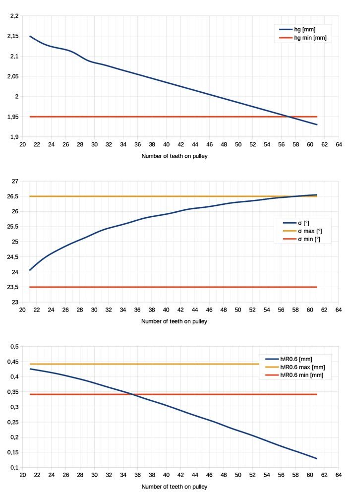

The calculating procedure begins with setting the number of teeth to be generated on the pulley. A small section on the reference profile, as shown in Figure 2, located where rounding R0.6 ends and flank begins, is generating the pulley’s profile at diameter dx. For this case study, the diameter dx was calculated using proprietary software (kzz) developed at Prozamet (Ref. 9). The same program was used for calculating the circular gap width on diameter dx, which was then compared with gr calculated from Equation 3. If these two are different, the gap width br is not equal to the specified value of 3.345 mm and the reference profile must be shifted to address that. The correct amount of reference profile shift was calculated with a modified Newton method. For a 25-tooth pulley, the calculated reference profile shift was –0.105 mm, and for a 30-tooth pulley it was +0.075 mm. The pulley’s profile flank angle σ was calculated from the slope of the generated section (Ref. 10).
Figure 4—Application range charts.
Pulley Profile Parameters Calculated for 25, 28 and 30 Teeth
Table 1 shows the parameters of pulley profiles calculated for 25, 28, and 30 teeth. The profiles were generated with a reference profile for a 28-tooth pulley (Figure 2).
All parameters are within their respective tolerances—a reference profile for 28 teeth can generate 25 teeth and 30 teeth profiles.

The Range of Application of a T5 28-Tooth Reference Profile in the Generating of Pulleys with Different Numbers of Teeth
The method and criteria described above have been used to determine the range of application of T5 28-tooth reference profile in the generating of pulleys with different numbers of teeth. The smallest number of teeth is 21 because below that a different set of parameters is defined in the ISO standard. The results are shown on the Figure 4 charts.
The factor limiting the range of application is the radial height of rounding R0.6 mm. The 28-tooth reference profile can generate pulleys ranging from 21 to 35 teeth.
