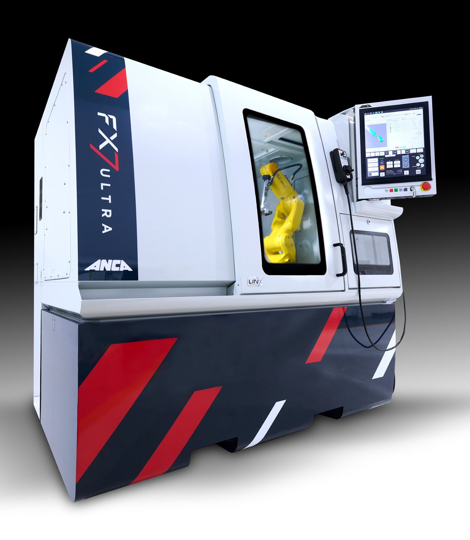

“The FX7 Ultra introduces cutting-edge technologies that revolutionize precision grinding for small tools down to 0.1mm diameter. If you produce tools such as ballnose, corner radius endmills, and complex or intricate profile tools, then this machine is for you,” says Darren Fox, ANCA Product Manager.
New software, hardware, and design features significantly improve surface finish, accuracy, and controlled runout, ensuring batch consistency from the first ground tool to the last. The FX7 Ultra is a refined solution for precision grinding in industries that rely on small tools, including electronics, telecommunications, medical devices, aerospace, automotive, die mold, and general machining.

A technical look at the FX7 Ultra's features:
Greater control for the velocity and acceleration or deceleration along with machine jerk limits: To increase the stiffness of the C-axis, the FX7 Ultra combines developments to the nanometer or micro degree resolution in the linear and rotary axis, tuning parameters, several system enhancements, and major mechanical changes.
Ultra-fast response to internal or external disturbances: ANCA’s newly designed servo control algorithm allows silky smooth motion of an axis with the use of a unique algorithm and nanometer measurement in the control system. This will create finer cutting edges and eliminate micro-chips making it more efficient when used in actual machining of materials.
Better cycle time and higher productivity of high-quality cutting tools: The unique algorithm is key to the performance of the machine and ensures outstanding tracking performance. It also allows Ultra-performance of the servo system without using a complex, complicated, or expensive mechanical system.
Reduces setup times and scrap: Cutting-edge software has been developed by ANCA to ensure batch consistency in large volumes. LaserUltra will maintain consistency and accuracy of the grinding process which includes in-process measurement and compensation to accommodate wheel wear and other external variations during large batch grinding. Its analog capability can maintain less than +/- 0.002mm line form accuracy of any profile which includes ballnose and corner radius tools.
Increased wheel life and better-quality tools: Tool and wheel performance can be further optimized by the iBalance software, which guides a user to the optimal grinding position and RPM for vibration monitoring and balancing the wheelpack inside the machine. Correctly balanced wheelpacks result in superior surface finish and reduced wheel wear due to the elimination of wheel vibration.
Consistency in finished tool quality: The total tool runout measurement and compensation operation is available in the iGrind software. When an endmill is in rotation it is important that each tooth hits at the exact same spot along the workpiece for longer tool life and efficient cutting. Every tool in the batch can be measured and compensated for runout to make sure the entire batch is within a tolerance of 0.002mm. It is another piece of assurance that the first endmill will be as good as the last.
Consistent spindle thermal stability: Motor Temperature Control (MTC) is a patent pending innovation built into the motor spindle drive firmware. Smart control algorithm actively manages and maintains the temperature of motorized spindles in the FX7 Ultra. Dramatically reduced machine warmup time means production can start sooner, once the machine has reached thermal stability. This improves productivity and machine use. Consistent thermal stability of the spindle over time regardless of changes in load or speed, or coolant temperature, greatly improves the dimensional stability of grinding results.
Post-grinding processes: The smoother, finer cutting edge and surface finish as a result of the combination of all the above including the nanometer control will assist in all post-grinding applications like edge preparation and coating. A finer edge that has been properly prepared has greater stability, which reduces the likelihood of it chipping, while also decreasing surface roughness which can cause increased friction between the tool and the workpiece.
