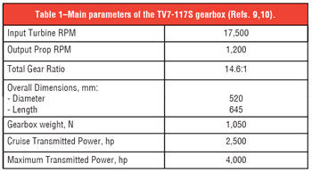

Gearbox Data
Main parameters of the TV7-117S gearbox (Refs. 9, 10) are presented in Table 1.

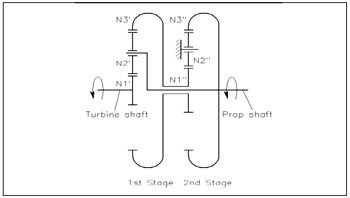

The TV7-117S gearbox arrangement (Fig.1) is the same as in previous-generation AI-20 and AI-24 turboprop engines. This arrangement has proved to provide maximum power transmission density for the required total gear ratio.
Figure 1--The TV7-117S gearbox arrangement.

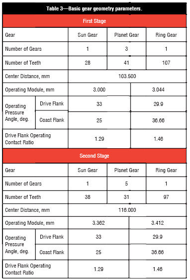

The first planetary-differential stage has three planet gears. The second coaxial stage has five planet (idler) gears and a stationary carrier. Part of the transmitted power goes from the first stage carrier directly to the propeller shaft. The rest of the transmitted power goes from the first-stage ring gear to the second-stage sun gear, and then through the planets to the second-stage ring gear, also connected to the propeller shaft.

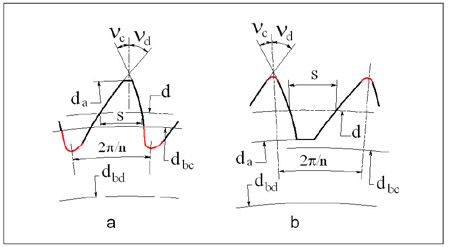

Direct Gear Design develops the asymmetric tooth form by using two involutes of two different base circles, as shown in (Fig. 3). The equally spaced teeth form the gear. The fillet between teeth is not in contact with the mating gear teeth. However, this portion of the tooth profile is also designed independently, providing minimum bending stress concentration and sufficient clearance with the mating tooth tip in mesh.
Figure 3--Asymmetric tooth profile (the fillet portion is red); a-external tooth; b-internal tooth; da-tooth tip circle diameter; db-base circle diameter; d-reference circle diameter; S-circular tooth thickness at the reference diameter; v-involute intersection profile angle; subscripts "d" and "c" are for the drive and coast flanks of the asymmetric tooth.

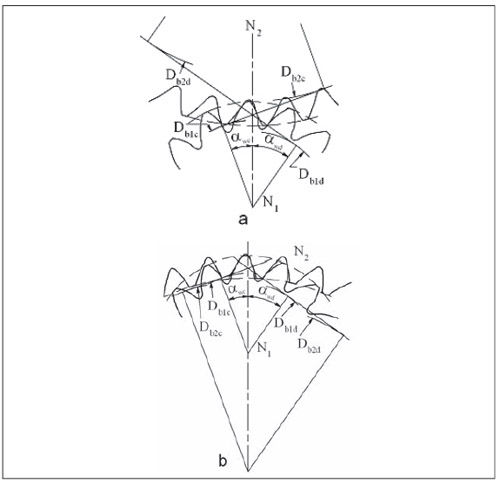

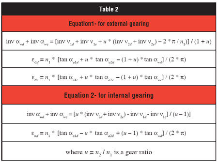

The asymmetric gear mesh (Fig. 4) presents two different drive and coast flank meshes with different pressure angles and contact ratios. The operating pressure angle αw and the contact ratio εα for the gear with asymmetric teeth are defined by the formulae in Table 2 (Ref. 3):
Figure 4--Asymmetric gear mesh; a-external gearing; b-internal gearing; aw-operating pressure angle; Db1,2-operating pitch circle diameters; subscripts "1" and "2" are for the mating pinion and the gear.
In propulsion gear transmissions, the tooth load on one flank is significantly higher and is applied for longer periods of time than the opposite one. An asymmetric tooth shape reflects this functional difference. Design intent of asymmetric gear teeth is to improve performance of the primary drive profiles by some degrading performance of the opposite coast profiles. The coast profiles are unloaded or lightly loaded during a relatively short work period. Asymmetric tooth profiles also make it possible to simultaneously increase the contact ratio and operating pressure angle beyond the conventional gears’ limits. In planetary gear systems, the planet gear is usually in simultaneous contact with the sun and ring gears. The tooth load and number of the load cycles are equal for both flanks of the ring gear. However, one flank of the planet gear is in mesh with the concave tooth flank of the ring gear with internal teeth. The resulting contact stress in this mesh is much lower in comparison with contact stress of the convex tooth flanks in sun-planet gear contact, which defines the load capacity and size of the gears. In order to reduce this contact stress, the higher operating pressure angle was chosen for the sun-planet gear contacting tooth flanks. This choice is in compliance with the ANSI/AGMA 6123-B06 standard "Design Manual for Enclosed Epicyclic Gear Drives," which states: "Best strength-to-weight ratio is achieved with high operating pressure angles at the sun-to-planet mesh, and low operating pressure angles at the planet-to-ring gear mesh."
The drive tooth flanks of the sun-planet gear mesh have increased the contact curvature radii, resulting in greater hydrodynamic oil film thickness. This also reduces contact stresses, because the increased relative curvature increases the tooth contact area. Basic gear geometry parameters are presented in Table 3.
Direct Gear Design of the asymmetric tooth profiles also allows shaping the coast flanks and fillet independently from the drive flanks, reducing tooth stiffness and improving load sharing while keeping a desirable pressure angle and contact ratio on the drive profiles. This allows both increasing tooth tip deflection and damping tooth mesh impact, leading to gear noise and vibration reduction.
αwd 2-3 = arccos [cos (αwc 1-2) * (n3-n2) / (n1 + n2)] (3)
Where
αwc 1-2 - coast operating pressure angle in the sun-planet gear mesh;
n1 - sun gear number of teeth;
n2 - planet gear number of teeth;
n3 - ring gear number of teeth.

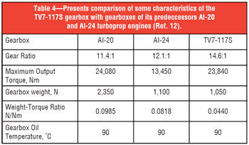

Summary
Application of the asymmetric teeth helped to provide extremely low weight-to-output torque ratio, significantly reduced noise and vibration levels--with less duration--and lower expense of operational development. Table 4 presents comparison of some characteristics of the TV7-117S gearbox with the gearboxes of its predecessors AI-20 and AI-24 turboprop engines (Ref. 12).
The new design and technological approaches that have found their realization in the TV7-117S engine gearbox were recommended for development of the gearboxes for advanced aviation engines.
