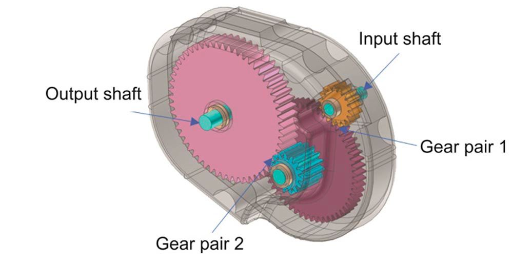

A two-stage gearbox model is considered in two variants with different gear materials, one with plastic gears and one with steel gears, see Figure 1. Both variants have the same input parameters (load, speed, number of cycles) and are designed to have similar root and flank safety. Therefore, the plastic gears are larger and have bigger diameters. The plastic gears’ strength is calculated according to VDI 2736, while the steel gears’ strength is calculated using ISO 6336. Both variants have the same housing material. Based on the load excitation imposed by the gears, the forced response analysis is conducted and at the bearing positions, the transient loads are evaluated.

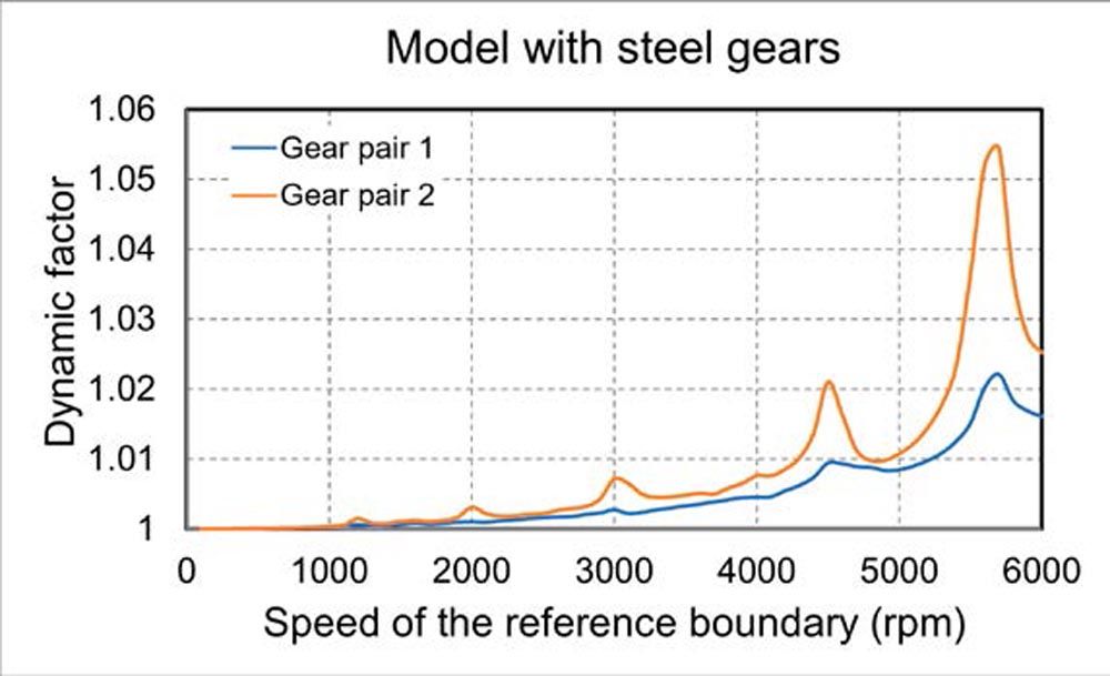

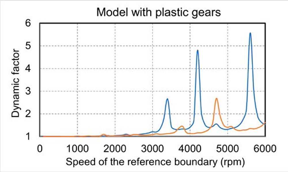

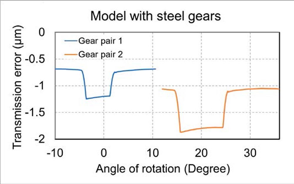

In the first step of the forced response analysis, the dynamic factor Kv is evaluated. The dynamic factor is the ratio of the maximum dynamic excitation load between the meshing gears to the static contact force. Kv of the first gear pair of both models without gear meshing damping is shown in Figure 2. The dynamic factor characterizes the system behavior under dynamic loading at different shaft speeds and reveals the margins of the operational speeds for which the powertrain system can be significantly excited. The increase of the dynamic factor in the model with plastic gears is much higher than in the other model when no gear meshing damping is considered. The main reason behind this difference is the high transmission error due to the low meshing stiffness of the plastic gears compared to the steel gears, see Figure 3. In the example used, the dynamic meshing forces of the plastic gear model without damping consideration increased up to 550 percent (Kv=5.5); whereas in the steel gear model, the increase is only about 5.5 percent (Kv=1.055) (Fig. 2). When we first obtained these results, we were searching for errors in the calculation approach, as—from practice and test rigs—we know that gear drives with plastic gears have lower excitations. However, the results changed completely when we rerun the calculations considering damping.
Figure 2—Dynamic factor without gear meshing damping, d=0 Ns/m.
Figure 3—Transmission error of the gear pairs.

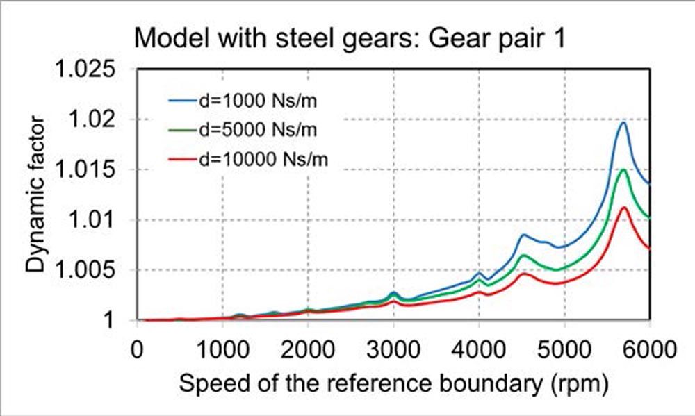

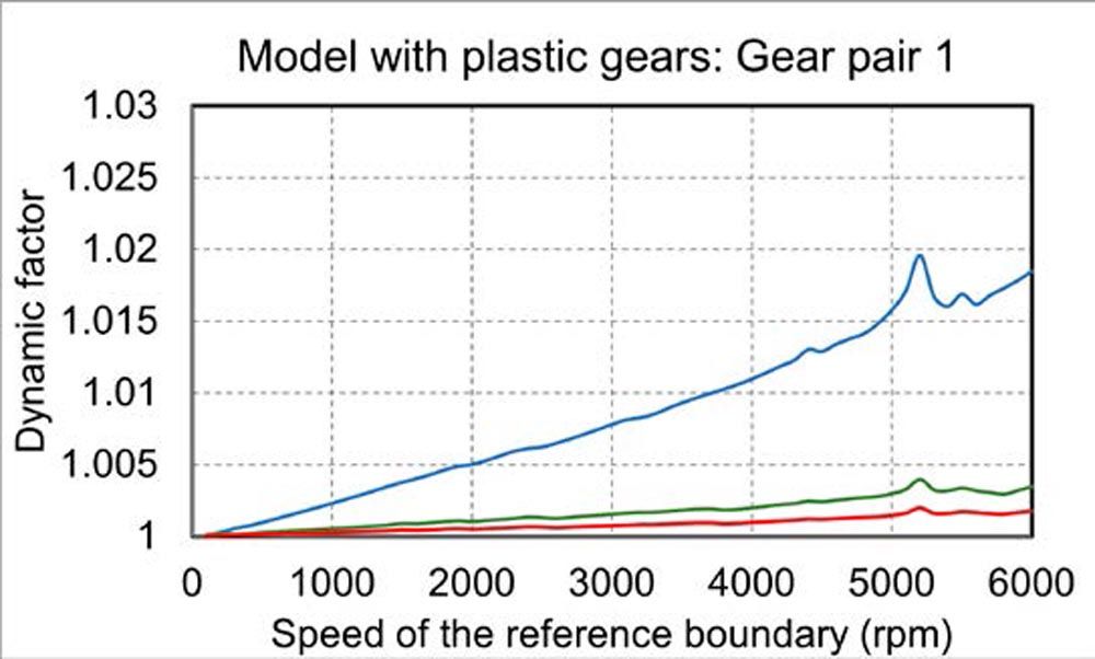

When considering the damping effect in the meshing, the effect on the dynamic meshing contact forces for the gearbox with steel gears is noticeable, decreasing in our example Kv from 1.055 to 1.020, see Figure 4. Note that a damping factor d=1,000 Ns/m is a good approach for steel. In the model with plastic gears, the damping decreased the dynamic factors dramatically; in our example, Kv came down from 5.500 to 1.015 with a damping factor d=1,000 Ns/m (and to 1.004 with d=5,000 Ns/m). It is difficult to obtain precise damping factors for plastic materials. After extensive research of the available literature, we determined the damping factor depends on the plastic type, temperature, and fiber reinforcement and that a damping factor of d=5,000 Ns/m is a conservative assumption to use.
Figure 4—Dynamic factor of the models with different gear meshing damping.
It is interesting to notice that the effect of damping already at low values is dominant, which means that the reduction of the dynamic factor from d=0 Ns/m to 1,000 Ns/m is higher than the reduction from 1,000 Ns/m to 5,000 Ns/m. The same conclusion can be drawn by comparing the dynamic factor reduction from successive damping increases. As the main conclusion from the above analysis, it reveals that for plastic gears, an analysis without damping is useless. This implies that the damping should not be neglected even when a very approximate damping factor must be used, otherwise it would lead to an unrealistic response of the system.

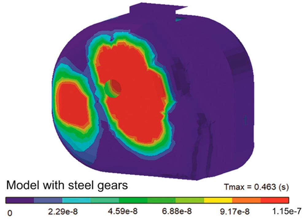

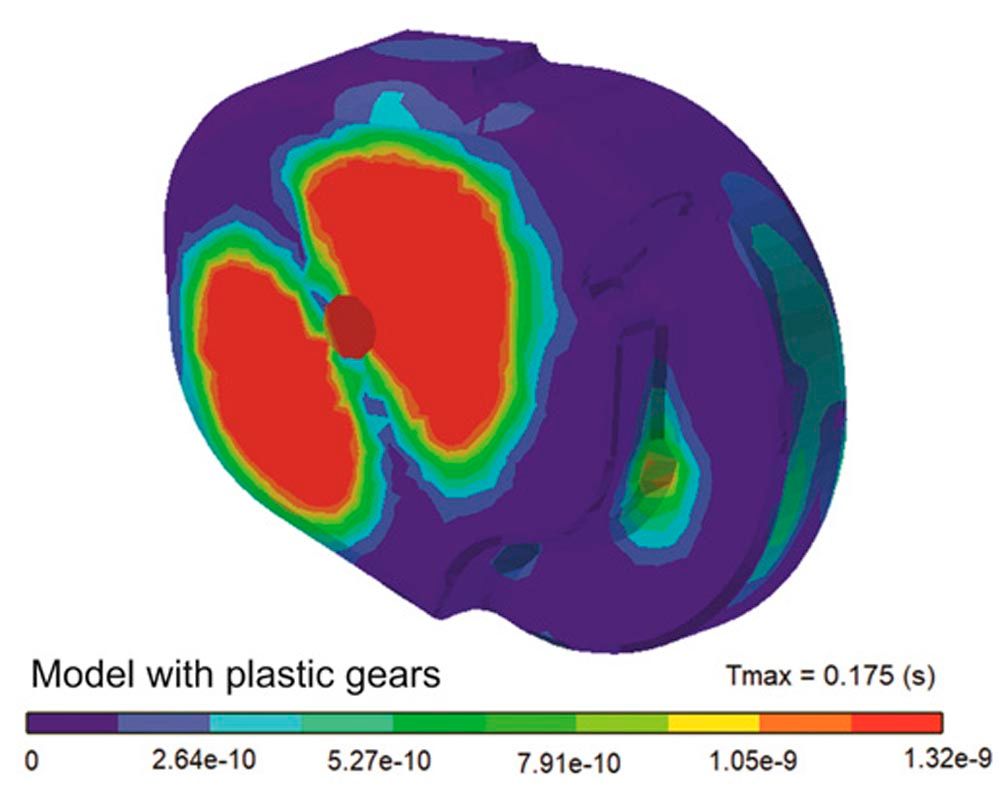

When executing an NVH evaluation, the gearbox housing is excited by the transient bearing forces at the bearing location points, and consequently, the noise emitted from the housing is evaluated. The bearing forces calculated in KISSsoft are imported to RecurDyn and applied directly to the housing of the powertrain model at bearing positions. As a major kinematic parameter required for the NVH analysis, the surface velocities at nodes of the meshed geometry are calculated. Finally, the equivalent radiated power (ERP), as the main factor for measuring the emitted noise level from the housing`s surface to the environment, is calculated. To demonstrate which parts of the housing’s surface emit higher noise, the contour plot of the ERP is very helpful. It can subsequently be used to address demanded design modifications, such as local stiffening of the housing utilizing the ribs, to reduce the noise. Based on the bearing reaction forces calculated in the forced response at a speed of 5,600 rpm, the ERP contours of both models are shown. In both models, the region of the housing close to the output shaft has higher ERP values, and consequently, emits noise to the environment. The plastic gears model has a much better performance concerning noise emission. The difference between the scales of the ERP of both models reveals this superiority (Figure 5). The maximum values of the color legends are adjusted to clearly show the noise distribution through the housing’s surface. It is noticeable to mention that the variation of the ERP depends on the simulation time and the locally evaluated position on the housing.
Figure 5—ERP contours at the time with maximum values at a speed of 5,600 rpm.
