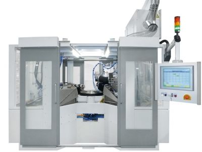

What are the manufacturing solutions that ensure the new high-performance engine components can be produced efficiently? ECM und PECM technology (Precise Electro Chemical Machining) from EMAG is one option. This process comes into its own where complex components are to be produced in demanding materials, as it machines high-tensile alloys and similar materials with a minimum of tool wear. The surfaces are of outstanding quality – with no burrs and no changes in the microstructure of the material. In contrast, using cutting processes could lead to a number of problems. The temperatures generated by traditional machining methods often have a negative effect on the microstructure of the material. Tool life in the machining of high-tensile materials is short. And the high infeed rates required to make the machining process economically viable, make the machining of filigree geometries difficult. It should therefore not come as a surprise that the demand for ECM is increasing in aero engine manufacture. Since EMAG entered into this technology in 2009, a number of their machines have been delivered to the supply chain for aero engine manufacturers, where they are used to machine central components, such as blisks, disks and individual blades in nickel alloys at speed and with great precision.
EMAG ECM, with headquarters in Gaildorf, near Schwäbisch Hall, Germany, offer a complete and comprehensive service in this process. They see themselves as their customers’ partners in development. The center of activities is an on-site laboratory, which offers the possibility to carry out feasibility studies and preliminary investigations on single- and multi-axes machines. In addition, the laboratory also offers comprehensive measuring systems (roughness, contour, coordinates). The laboratory not only establishes the feasibility of a project, but also the cost-benefit ratio of the process with a view to the specific component and the material it is made of. This way, the customer will find out what component tolerances and cycle times he can expect to achieve.
That the technological demands of the experts at EMAG ECM are far-reaching is shown by the fact that they work in close cooperation with the machine tool laboratory at the RWTH (Rhenish-Westfalian Technical College) Aachen. It is here that experimental analyses for the electro-chemical machining of materials establish the feasibility of the process and where improved cathode designs are simulated. The comprehensive objective is integrated optimization. The process is constantly developed further with a view to the incorporation of new materials and changing component geometries.
Large batch sizes, hardest possible materials, precision results without negative effect on the material, perfect surfaces – this is the background against which the outstanding market opportunities for the machine builder and their technology in aero engine manufacturing are generated. The company offers a modular machine concept that can be quickly tailored to suit individual component requirements. The customer also benefits from the generally high degree of EMAG expertise in the development and manufacture of machine tools. Pivotal innovations, such as Mineralit machine base, intelligent soft- and hardware interfaces and effective automation solutions are part of the company’s developments. It ensures that EMAG ECM can create tailor-made (P)ECM turnkey solutions.
