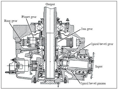

OH-58D main-rotor transmission. The OH-58 Kiowa is an Army single-engine, light observation helicopter--an advanced version developed under the Army Helicopter Improvement Program (AHIP). The OH-58D main-rotor transmission is shown in Figure 1. It is currently rated at maximum continuous power of 410 kW (550 hp) at 6,016 rpm input speed, with the capability of 10 sec torque transients to 475 kW (637 hp), occurring at a maximum of once per hour. The main-rotor transmission is a two-stage reduction gearbox with an overall reduction ratio of 15.23:1. The first stage is a spiral bevel gear set with a 19-tooth pinion that meshes with a 62-tooth gear. Triplex ball bearings and one roller bearing support the bevel pinion shaft. Duplex ball bearings and one roller bearing support the bevel gear shaft. Both pinion and gear are straddle-mounted.
Figure 1--OH-58D helicopter main-rotor transmission.
A planetary mesh provides the second reduction stage. The bevel gear shaft is splined to a sun gear shaft. The 27-tooth sun gear meshes with four 35-tooth planet gears, each supported with cylindrical roller bearings. The planet gears mesh with a 99-tooth, fixed ring gear splined to the transmission housing. Power is taken out through the planet carrier splined to the output mast shaft. The output shaft is in turn supported on top by a split, inner-race ball bearing, and on the bottom by a roller bearing. The 62-tooth bevel gear also drives a 27-tooth accessory gear. The accessory gear runs an oil pump--which supplies lubrication through jets and passageways located in the transmission housing--as well as a hydraulic pump for aircraft controls.
