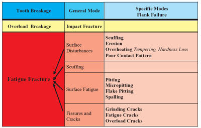

Failure Mechanisms
Typical failures on the gear wheel are tooth breakage and damage to the tooth flanks. Tooth breakages can be impact fractures or fatigue fractures. Tooth flank damage is a symptom of wear and can lead to fatigue fractures. The types of failure are shown in Figure 1.
Figure 1—Failure mode classifications for gears according to ISO (10825).
Figure 1 includes erosion as a surface disturbance failure mode. Erosion is material removal associated with liquid impingement from oil jets in high-speed gearing. Erosion can be avoided by using special nozzles with a soft oil-jet flow to spray the gear mesh.
