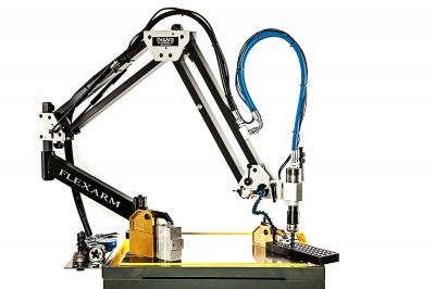

FlexArm Inc., will feature a mobile tapping package which yields mobility, productivity and efficiency by allowing operators to tap holes offline while the machining center works on the next part, in IMTS booths 432115 and 236430. This comprehensive package includes the FlexArm GH-18 tapping arm with a tap capacity of #6 to 5/8", a reach from 17"-72", variable speed from 100-420 RPM, 360-degree movement and a semi-automatic tap lubricator. Additionally, with a caster cart, power pack, tap stand and five tap holders, this hydraulic tool can be used wherever there is 110V available - with no air needed. With fast set up times and significantly reduced tap breakage, FlexArm tapping arms are an ideal alternative to tapping holes manually, or via CNC.
FlexArm provides a more efficient way to tap holes. They allow machining centers to do what they do best - milling, drilling and boring. When operators load a machining center and start its cycle, they can use that cycle time to tap previously machined parts with the FlexArm - yielding more productivity per shift. Tap breakage rates are significantly reduced with the FlexArm due to its purpose-centered approach. With a tap breakage rate of 1 per 3000 holes, versus 1 per 300 holes on a CNC, FlexArm tapping arms can significantly reduce set-up time, cost, and scrap rates.
