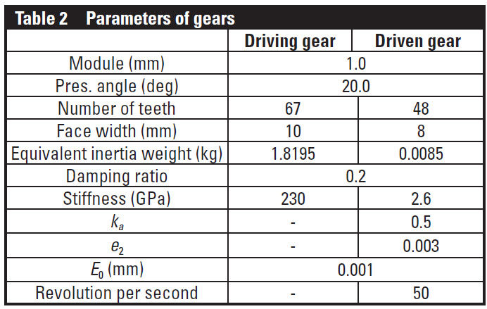

Numerical simulation of meshing gear vibration. According to the abovementioned gear model, numerical simulations of meshing gears are carried out using the Runge-Kutta Fourth Order Method (Table 2). The step time of the simulations is 10-6 s, and σsmooth = 10-2.
The results of numerical simulations are shown in following figures. Figure 3 shows the change of the natural frequency of the system.
