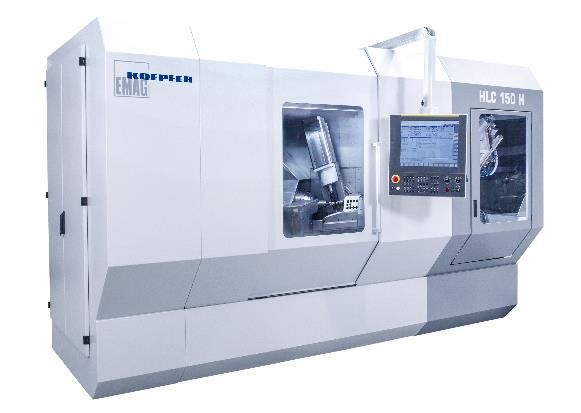

The HLC 150 H gear hobbing machine from EMAG Koepfer ensures high surface quality on components with a maximum length of 500 millimeters and a weight of 10 kilograms.

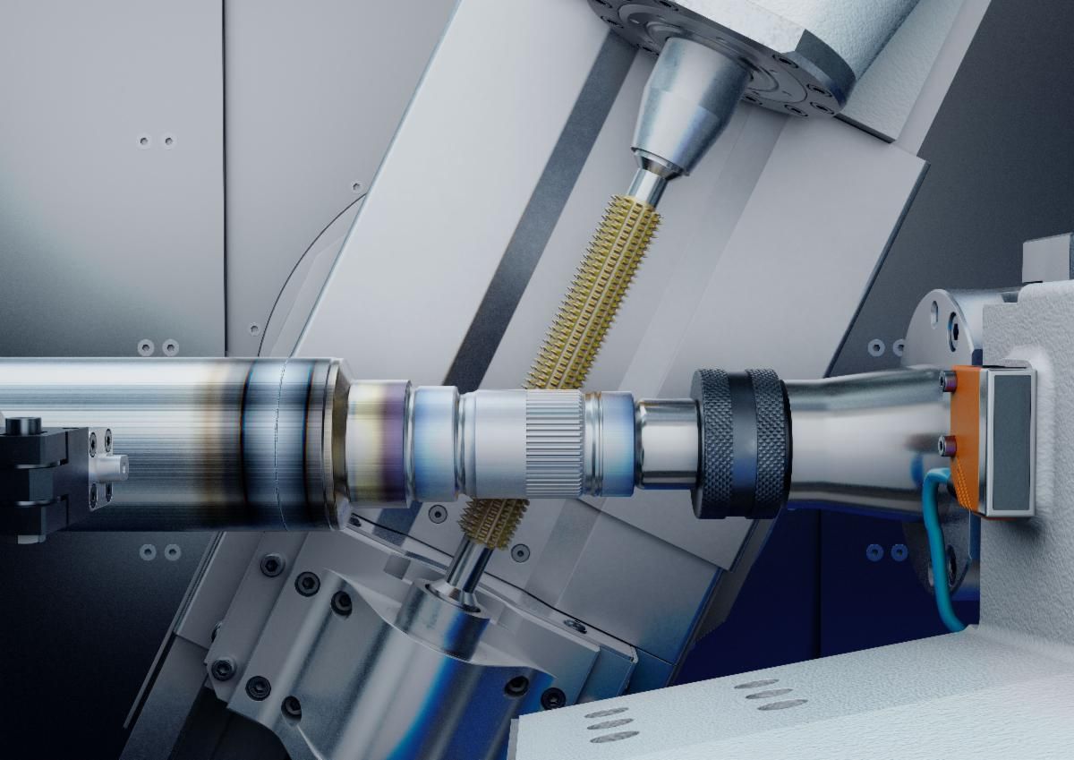

High motor speeds on the milling head and main spindle enable high cutting speeds.

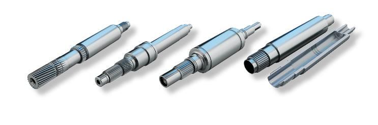

With the HLC 150 H and the K 160, EMAG Koepfer offers a wide range of gear solutions for rotor shafts.
