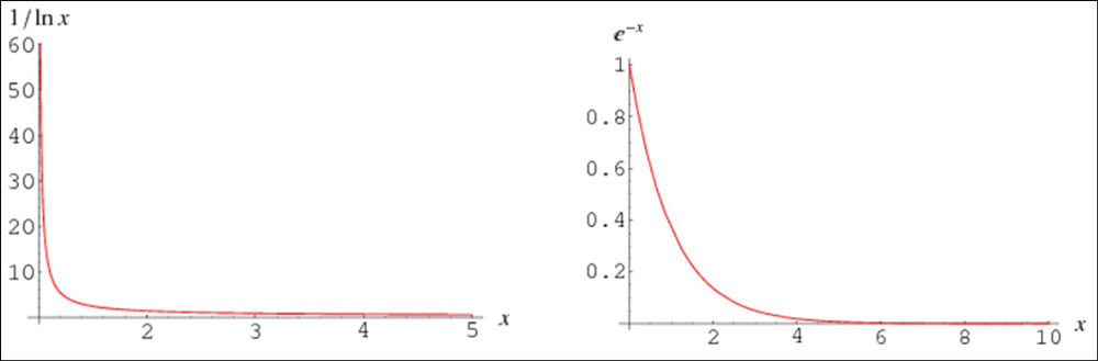

Figure 1 Comparison of logarithmic decay (left) and exponential decay (right).

Bylund (Ref. 7) discusses that a logarithmic decay in depth of cut would be the most appropriate method to use. When assessing a logarithmic decay, it can be seen that the initial gradient of the decay is very steep, essentially taking an initial cut of extreme depth followed by many cuts of very little depth. An exponential decay would allow for a gradual transition from deep cuts to shallow cuts and is therefore more suited to a machining process. The logarithmic and exponential decrease curves are compared in Figure 2.
The AMRC previously created and tested a spreadsheet calculator that would give an exponential decrease for a given gear depth but would use maximum and minimum depths of cut to suit machining processes and also set boundaries for the exponential decay to remain within. Machining processes generally begin with deep roughing cuts to remove large volumes of material, but these are limited to a maximum depth due to the cutting force required at greater depths. The inverse applies to the final tool paths, as a minimum limit is required in order to reach the material shear force; these are the limits in which the exponential decrease must occur between in order to reach the required total gear depth. This work highlighted the requirement to further control the force through each cutting pass.
