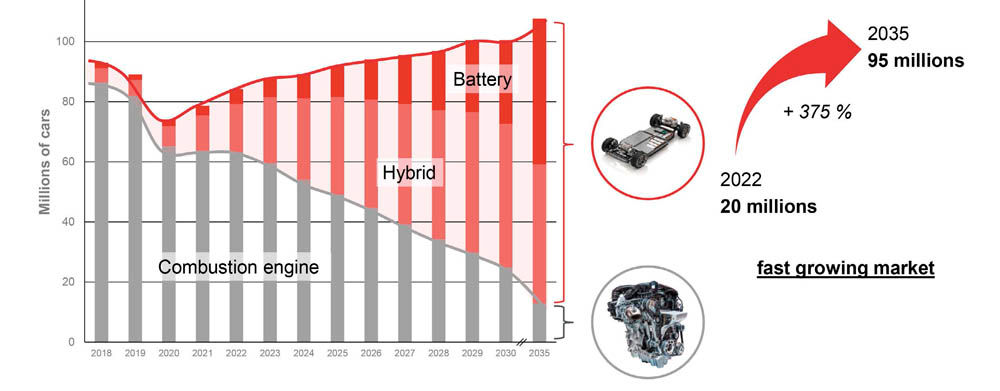

Overall developments and widespread public awareness of man-made climate change are transforming the way people think. The awareness has inspired a shift towards a more ecologically sustainable way of life. Driven by policymaking and technological innovation, ambitious efforts are underway to reduce greenhouse gas emissions to curb the rise in average temperatures. A key focus of these efforts is the mobility sector. Several different forecasts from major consulting companies indicate that, over the next 10 to 15 years, we can expect to see a clear trend away from combustion engines and towards the use of electric vehicles (Ref. 1).gt0924_Page_54_Image_0001.jpg
Figure 1—EV sales forecast (Ref. 1).

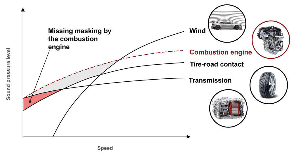

By replacing the combustion engine with an electric motor, this new drive concept eliminates one of the main sources of noise in the car. As a result, undesirable sounds, which had previously been masked by the optimized sound design of combustion engines, can potentially come to the foreground. To illustrate this, the following figure charts the qualitative behavior of sound pressure levels from various sources of noise in the vehicle interior as a factor of speed.
Notice how the transmission noise had previously been masked by the sound of the combustion engine. With this engine gone, the sound of the transmission comes to the foreground. Once a certain speed is reached, the tire-road contact gains dominance, concealing the sound of the transmission (Ref. 8).
Figure 2—Noticeability of transmission noise (Ref. 8).

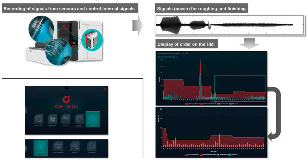

Typically, to assess the grinding process, a small sample is inspected by tactile measurement, however, individual outliers cannot be reliably detected. This is where Kapp Niles‘ own process-monitoring system comes in, enabling 100 percent evaluation in real time. Based on internal signals from the machine control system and their multiple acceleration sensors, characteristic values are obtained which can be used to evaluate both the grinding and dressing processes.
For the dressing process, a single index is compiled which reflects the entire dressing process, thus also indicating the condition of the grinding worm. This index can then be clearly represented in a diagram and compared with the preceding dressing cycles. Threshold values for this characteristic make it possible to initiate an action on the part of the machine. It is also possible to perform a deep analysis of the raw data from the dressing cycle directly in the machine control system.
Compared to the dressing process, the grinding process is more complex and requires many various characteristic values to be described effectively. In the simplest case, this means maximum or mean values. For the most exacting quality requirements regarding waviness and noise-vibration-harshness (NVH) behavior, characteristic values are obtained by breaking the time-discrete grinding signals down into frequency components and analyzing them (see Figure 3).
Figure 3—Process monitoring.
This process monitoring method is comparable to the method used in tactile spectral analysis, the roller and the end-of-line (EOL) test bench. In all cases, a signal (albeit from different sources) is broken down into frequency components and associated with a wheel revolution. The order spectra generated in this manner can be correlated with one another and contain similar information. It should be noted, however, that as opposed to tactile measurement, the values are not absolute. Rather, these are values that must be statistically analyzed and compared to the other measuring processes to obtain effective threshold values.

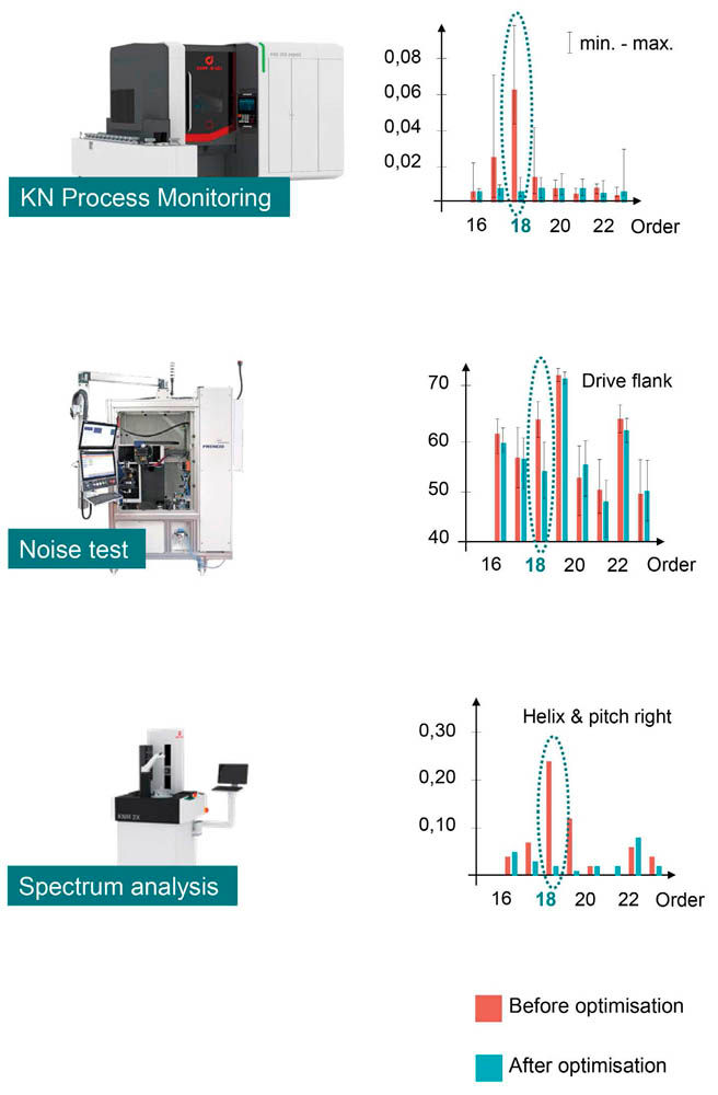

The following practical example shows how the grinding process can be effectively monitored regarding the noise characteristics of the gears. In the case illustrated here, anomalous gears are repeatedly identified in the EOL test by cross-exchanging the gearbox components. Such an anomalous gear excited the gearbox in the frequency of the 18th order to such a degree that undesirable noises were produced in the vehicle. Subsequent analysis showed that both a tactile spectral analysis and a roller test indicated irregularities in the 18th order in the anomalous gears. Kapp Niles aided by performing a deeper analysis of the raw data from these measurements. To optimize the grinding, process monitoring was installed on the affected grinding machine. After a few components, it was possible to reliably detect the 18th order. After the fault in the grinding process was eliminated by optimizing the rotor shaft, a significant reduction in the 18th order could immediately be seen in the process monitoring data. The tactile spectral analysis, the roller test bench result and the EOL test all corroborate the process monitoring data (see Figure 4).
Figure 4—Comparison of different quality control methods to describe noise characteristics.
It was demonstrated that the process monitoring system developed by Kapp Niles is capable of effectively detecting noise-generating components during grinding. Warning or abort thresholds can be input.
