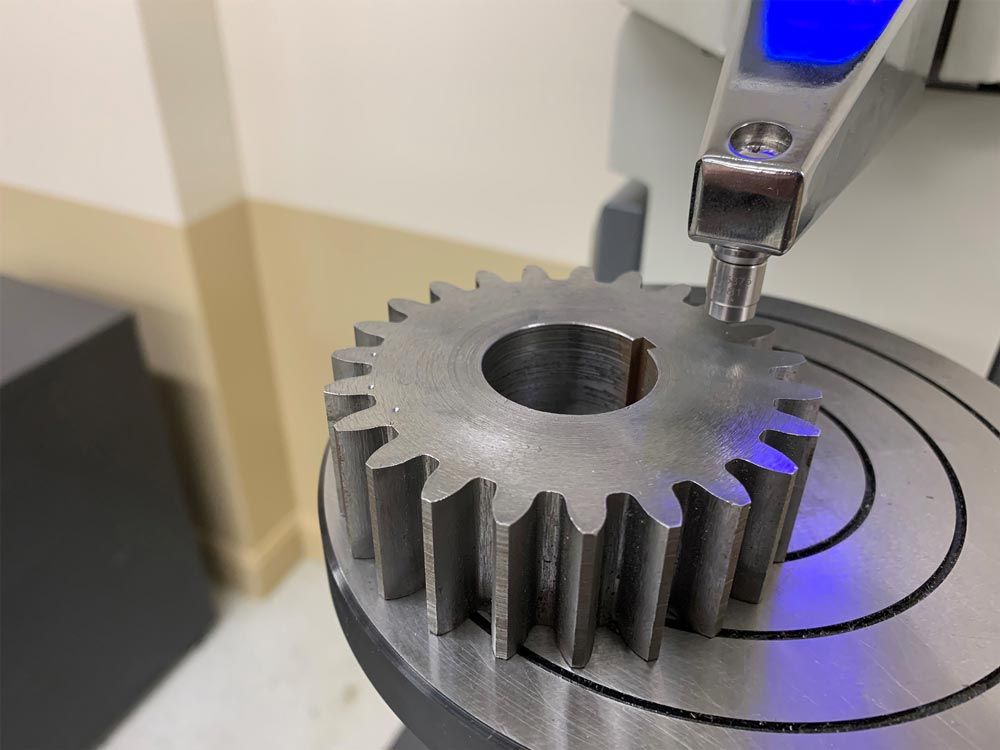

Ultrasonic portable hardness testers probably offer the best of most worlds for gear inspection/ testing. Testing can be done from any angle, while getting into very tight spaces often found in gears. Because testing can be done nondestructively, whether you are checking material or platings, tests can be accomplished without leaving a mark on most metals. The speed of the UCI tests is approximately 2 seconds. In addition, workload can be automated using fixturing and a stand to hold the probe in place, allowing for rapid, continuous testing.
Starrett 3821 Ultrasonic Portable Hardness Tester will test gear teeth nondestructively and can read in just about any scale at about two seconds.
UCI is based on a 136-degree diamond at the end of a vibrating rod being depressed into the test surface at a fixed load. The difference in Ultrasonic vibration frequency is then calculated into a hardness value. The UCI test procedure is slower than the Dynamic Impact style, however the UCI method has the advantages of being nondestructive and able to test thin and small work parts.
Previously, destructive indentations made on such sample pieces meant the garbage heap for those tested. Using ultrasonics, this is no longer the outcome. These systems have an open architecture and can be calibrated to read any metal, in any hardness scale, with reference samples to perform initial calibration. Ultrasonic portable hardness testing is ideal for applications such as gears, bearings, pistons and valves, among many others. Key industries for this type of testing include aerospace, automotive and medical parts as well as knife blade manufacturing, to name just a few.
