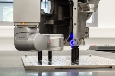

Hexagon’s Manufacturing Intelligence division recently launched its first blue laser scanning sensor for creating point clouds. The HP-L-5.8 joins Hexagon’s comprehensive range of tactile and non-contact sensors for CMMs and is designed for companies who need a versatile, affordable, fixed-line laser sensor.
The HP-L-5.8 performs equally well when taking point cloud measurements from dark or shiny surfaces. Designed to be rugged and compact, it protects the sensor from collisions and vibrations and is ideal for use in areas where accessibility is restricted as well as on smaller CMMs.
“Increasingly our customers want to add the speed and wide measurement coverage of laser scanning to their CMM’s capabilities,” says Christian Schorr, Hexagon’s product manager for laser scanners on CMMs. “The HP-L-5.8 meets our customers’ demand for an accurate, affordable laser scanner that turns a CMM into a multisensor machine that can switch easily between tactile probing or laser scanning in a single part program."
The HP-L-5.8 is seamlessly compatible with Hexagon CMMs that use PC-DMIS 2018 R2 and subsequent versions of the software and works with an automatic indexing probe head or continuous wrist, making it easy to operate for users of tactile probing tools.
