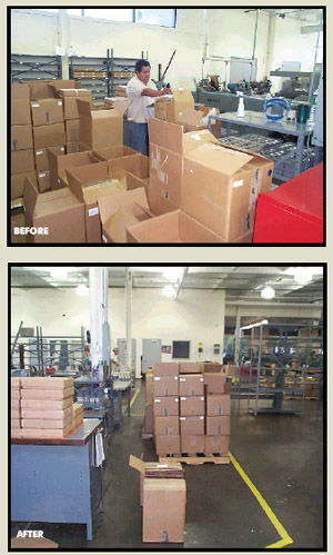

A picture is worth 1,000 words. A “before-and-after” photo clearly demonstrating the effective result of 5S / Lean changes to Precipart’s shipping department processes.

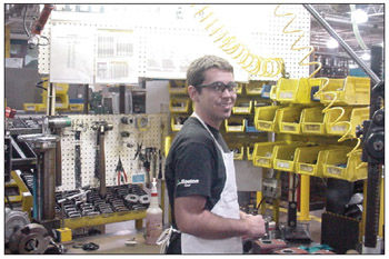

Boston Gear’s Jerry Leadbetter at his speed reducer assembly station. Note the Lean-inspired shadow board in the background with job-specific tools in perfect order. Note, too, the trays in the foreground containing job-relevant parts, another Lean principle.

At Boston Gear, improvements in the shipping department have been kaizen-intensive, leading to various Lean tools integration.
For instance, says Prosser, “One project was to match pick location with product popularity. After performing numerous time studies, we were able to determine the inventory locations with the easiest—and quickest—pick times. We then defined our products into three categories—‘A’ items are frequently picked; ‘B’ items are seldom picked; and ‘C’ items are rarely picked. We then moved our ‘A’ items to the most desirable locations in the warehouse, based on picking speed and ease of picking.” And so forth. Another kaizen-inspired upgrade was a “visual picking board,” which allows supervisors to track in real time the workload of each on-shift picker. That information is then used to assign picking orders to those handlers with the available time and opportunity relative to an order’s priority. It’s a classic application of Lean principles.
