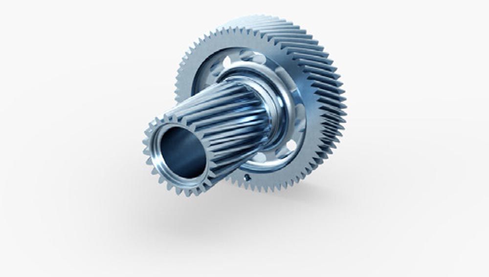

VarioChamfer is a solution for the critical components in planetary gears: the so-called stepped planets (see Fig. 1) and the ring gears (see Fig. 2).
Figure 1—Illustration of a stepped planet.
Figure 2—Illustration of a ring gear.
In stepped planets, two gears of different sizes with a small distance from each other comprise the workpiece. Nowadays, the parts are usually machined using skiving, e.g., on the Präwema SynchroFormV. As with any machine operation, this process produces a burr on the exit side of the peeling tool. This burr is inevitably located exactly between the two gears, which are usually arranged at a small distance from each other (see Fig. 3).

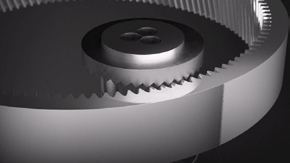

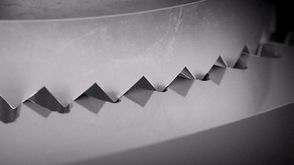

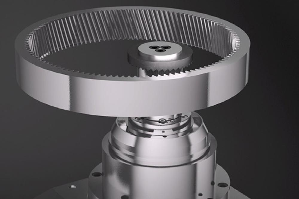

Figure 3a-3c—With VarioChamfer, a ring gear can be splined and deburred in a single clamping operation.
“This is where the VarioChamfer process plays to its full strength due to its space-saving tool.
Ring gears are internally geared components. As in the previous example, the burr occurs on the exit side of the gearing due to the cutting process. Here we have geometric limitations because this area is inside the clamping. Using a similar type of tool as for the stepped planet, collision-free immersion into the workpiece and chamfering is possible,” Painczyk said.
A particular advantage of the VarioChamfer process is that the workpiece can be deburred in the same clamping in which it was geared (see Fig. 3). It is not necessary to set it down and turn it over, which means no additional solutions are needed. The workpiece is deburred right after gearing.
