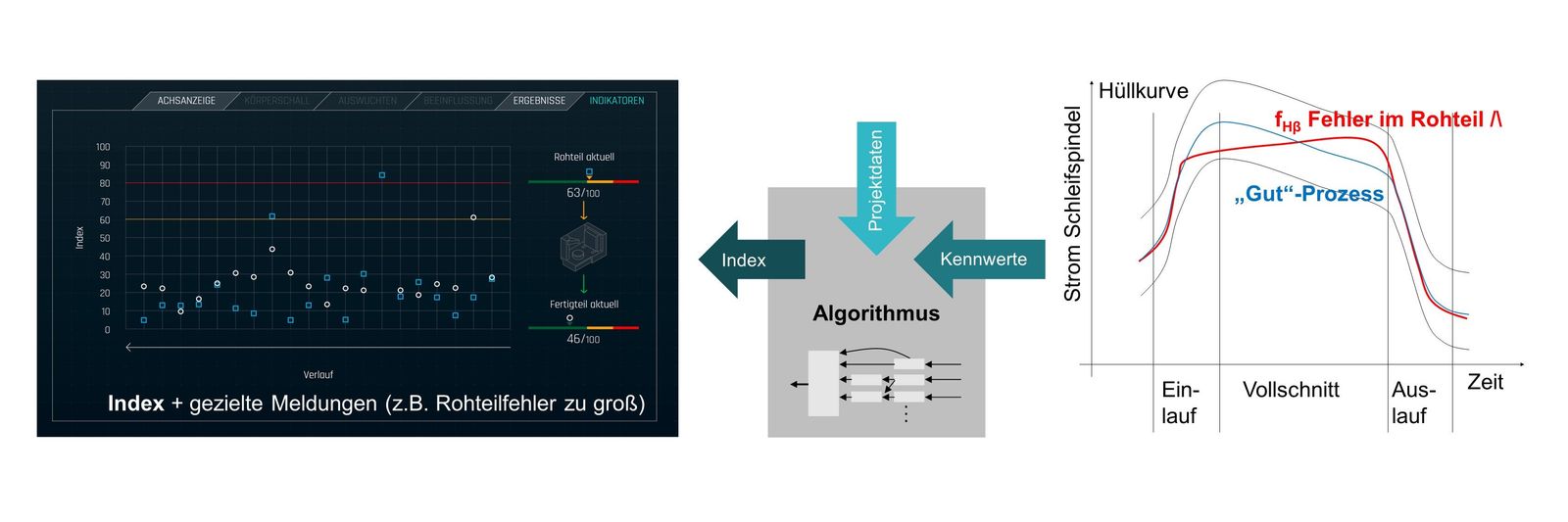

Figure2.jpgFigure 2 - Error analysis and index calculation in the machining process.
Process monitoring: Intervene before it is too late
Process monitoring can be defined as component-specific monitoring and evaluation of the grinding process. As described, it is not trivial to generate instructions for action from the sensor signals. But it is possible. Various characteristic values can be formed from time signals. In the simplest case, these can be maximum or root mean square (RMS) values of the signals. The characteristic values are then combined with the known project data via algorithms and processed into indices, for example, into a noise or screw breakout index.

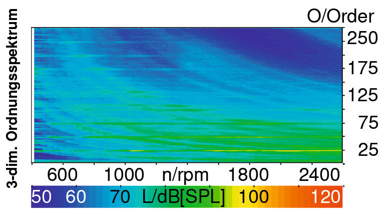

“For noise-critical components, an order analysis similar to the order spectrum on an end-of-line test bench can be created via fast Fourier transformation (FFT). This allows the recorded signals to be better classified and related to results on the transmission test bench (Figure 3). Nonprepared measurement data have no use,” Stegner explained specifically about transmission noise.
Figure3.jpgFigure 3 - Order spectrum taken on a gearbox test bench.
In the end, especially in the manufacturing environment, only appropriate indices help to identify very specific errors.
Benefits of process monitoring therefore can be determined by 100 percent testing of all components, the identification of abnormalities still in the grinding process, detection of component-specific errors, targeted reporting of irregularities, adaptive intervention in the process and parts tracking.
